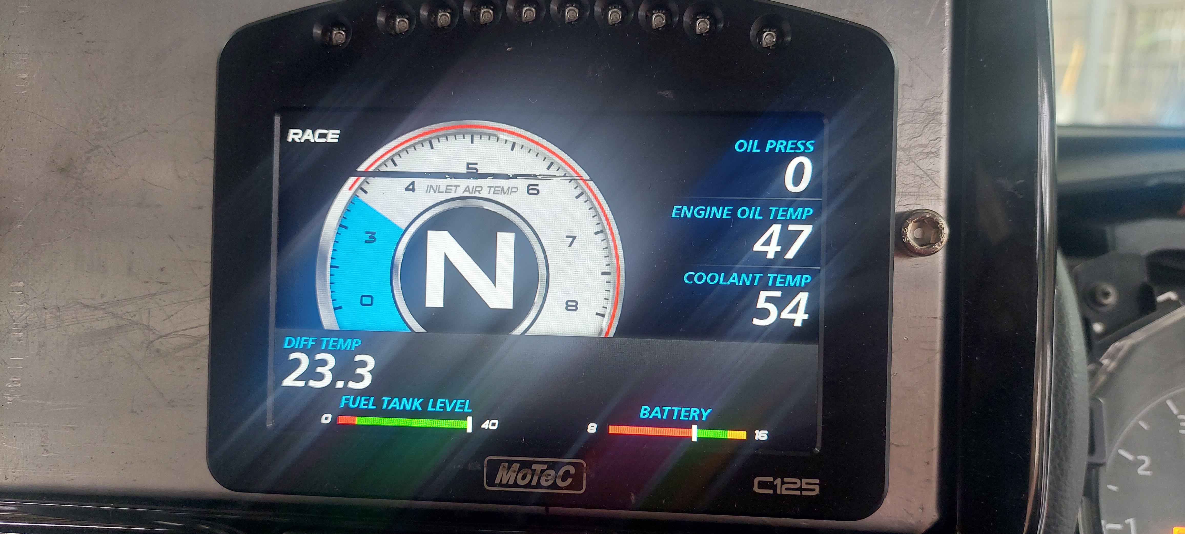

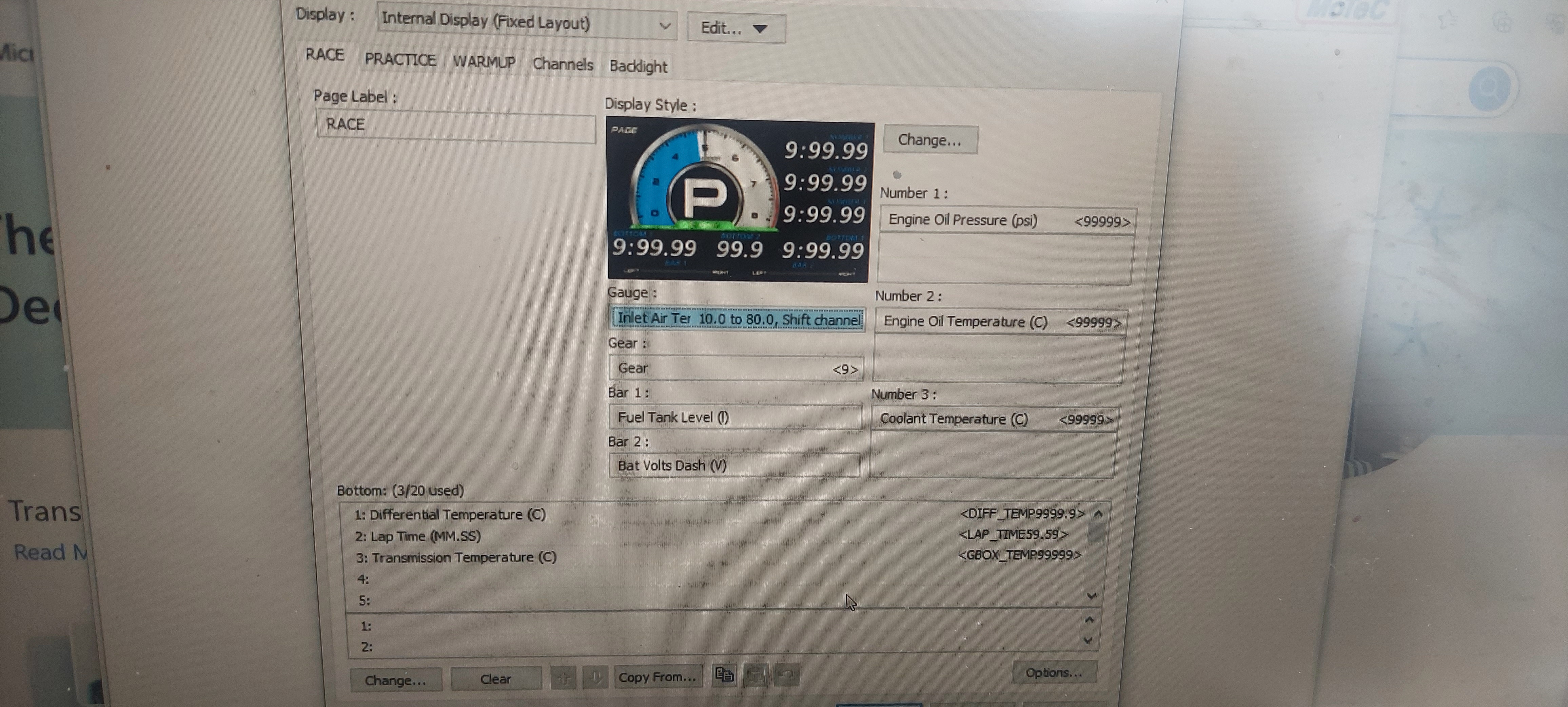

I cant seem to get gearbox temp to display on my C125 dash which is connected to a M1
if you look at the pics, the actual display of gearbox temp is allocated to the bottom line. Diff temp is there. G'box temp is missing.
lap time is also missing but im assuming thats cause the car is stationery'. Im quite sure it worked when i track tested the car recently

Hi Terry,
At present you have each value (diff temp, lap time and transmission temp) each on separate lines, not three values across a single line.
If you wish for all three values to show up at the same time next to each other, you will need to double click on the diff temp (or the first line in the bottom section of the display configuration) and tick on the 'value 2' and 'value 3' boxes, and place the desired channels in each of these. This will allow three channels to be shown on the bottom row.
At present the value displayed in the left slot in the bottom row will change when the 'display next line' channel becomes true.
This channel is normally tied to a user condition or directly to a button to scroll through these lines. If this is the method you want to use, save your current config and select file > new > m1 ecu and review the config. In this config the 'next button' is assigned to an available wired input, and the second user condition uses this button to trigger the 'display next line' channel, which will make the display change through the row of displayed values on the bottom row once for each button press (ie. Change to the next line)
