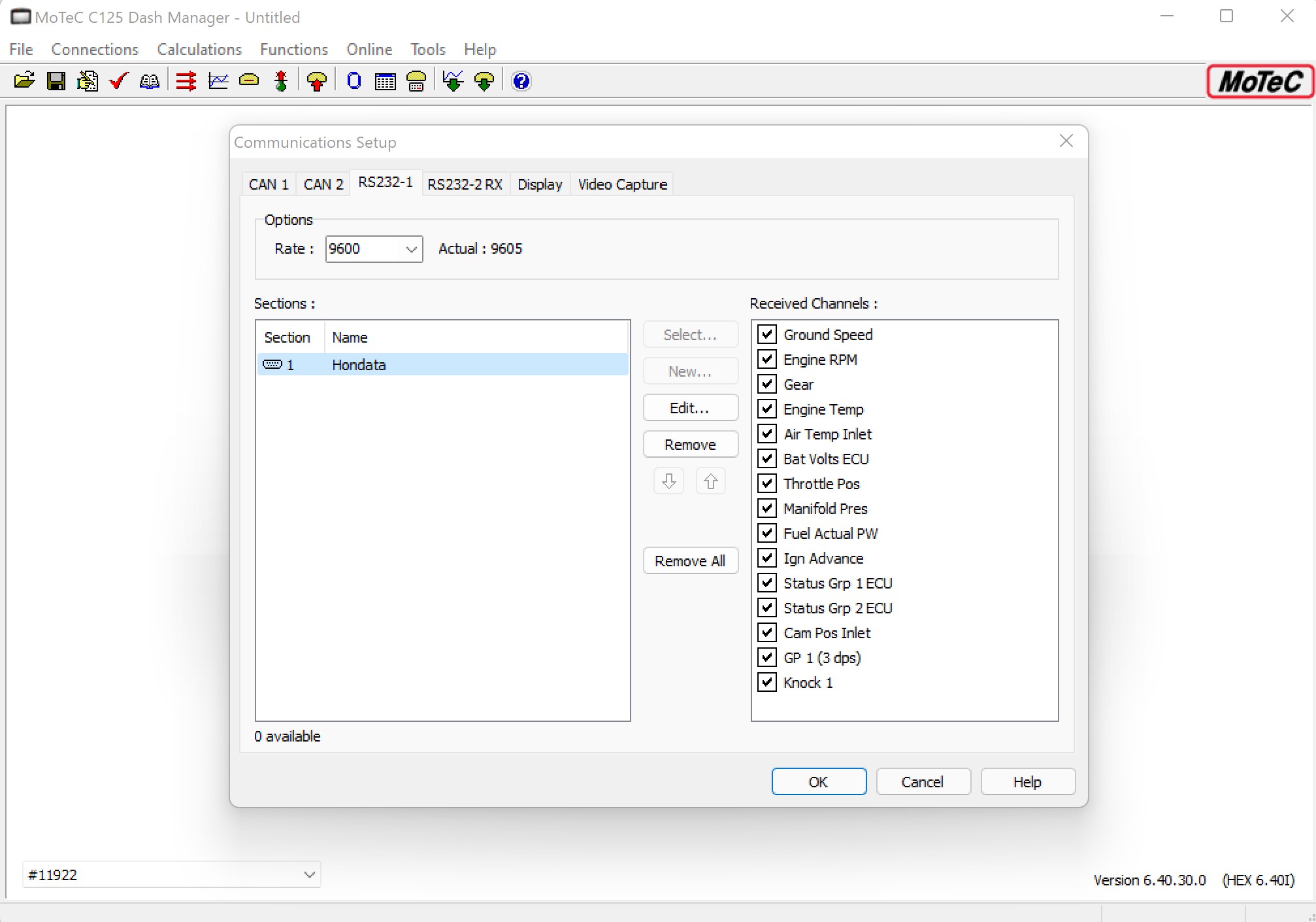

Our dash software only supports the CAN based OBD2 messaging protocols. If you have a Hondata chip in your ECU, we have templates for the Hondata serial messaging.

Postby NathanB on Sat Feb 19, 2022 12:43 pm
Hey Ady,
It's entirely possible depending on the particular K series ECU you have.
The guide for enabling serial output on the ECU is here on the Hondata website:
https://www.hondata.com/help/kmanager/i ... output.htm
When this is done, we have an RS232 template in the dash manager software you can use.
Hondata Serial Template
Hondata serial format.jpg (234.77 KiB) Viewed 6923 times
