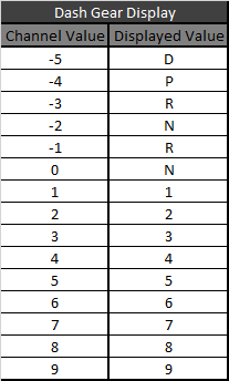

With Fixed Display setups (ie not Display Creator ones) the centre number is hard coded as a gear indicator. Below is what is displayed for each channel value.
Dash Gear Values.png (5.09 KiB) Viewed 6701 times

If you use -6 the display will show blank. I set up a counter from my driver switch to count from 0 to 4 postions. I then made a 2D table with the input being the counter output channel being 0=-6, 1=1,2=2,3=3 and 4=4. I then named the output channel of the 2D table "SKIDOO BOOST FOR GEAR DISPLAY" then simply used that channel in the gear and you will have you boost levels displayed or as I like to refer to it as "stage 1,2,3 ect" with a blank setting being zero.
You can also set it up so the display will only go down to or start at 1 by setting up your counter to start a 1 instead of zero then making the change in the 2d table.
