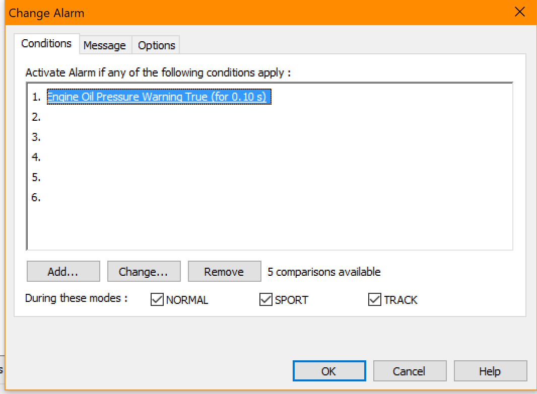

Using Warning state for alarm
Dash alarm.PNG (24.98 KiB) Viewed 4343 times

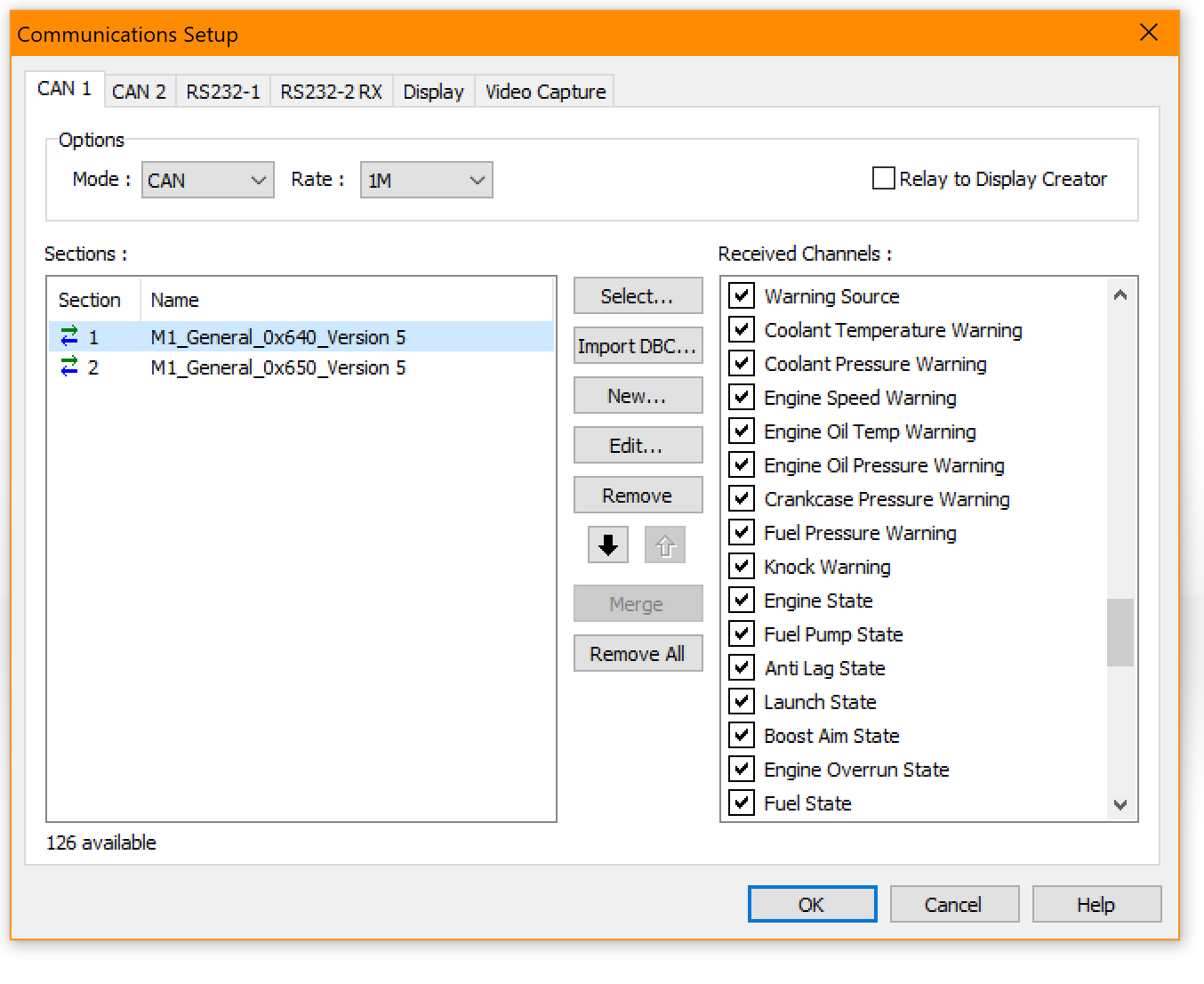

Channel warnings in dash templates
x640 warning channels.PNG (70.76 KiB) Viewed 4343 times

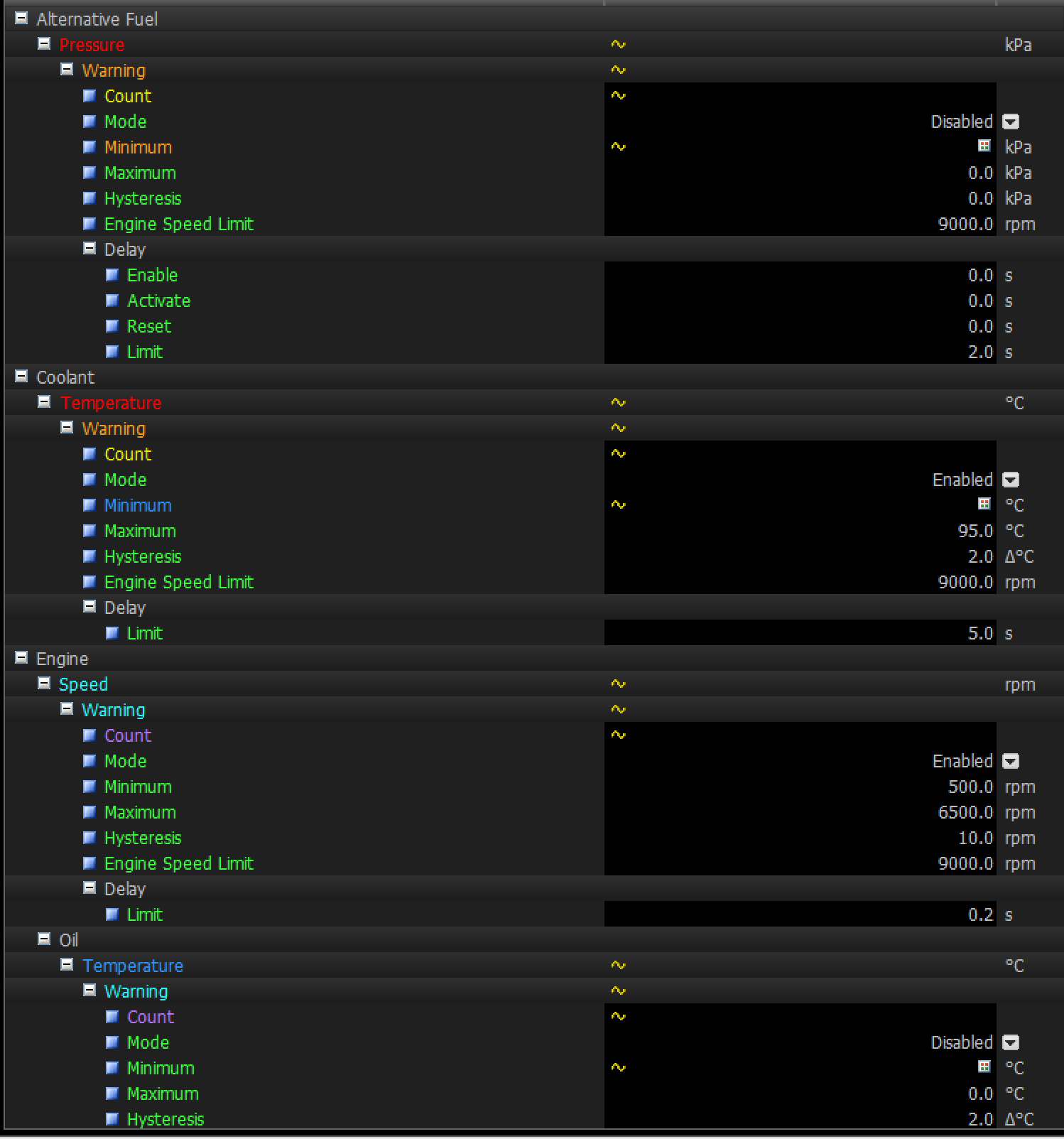

M1 Tune channel warnings
Channel warnings M1.PNG (84.78 KiB) Viewed 4343 times
