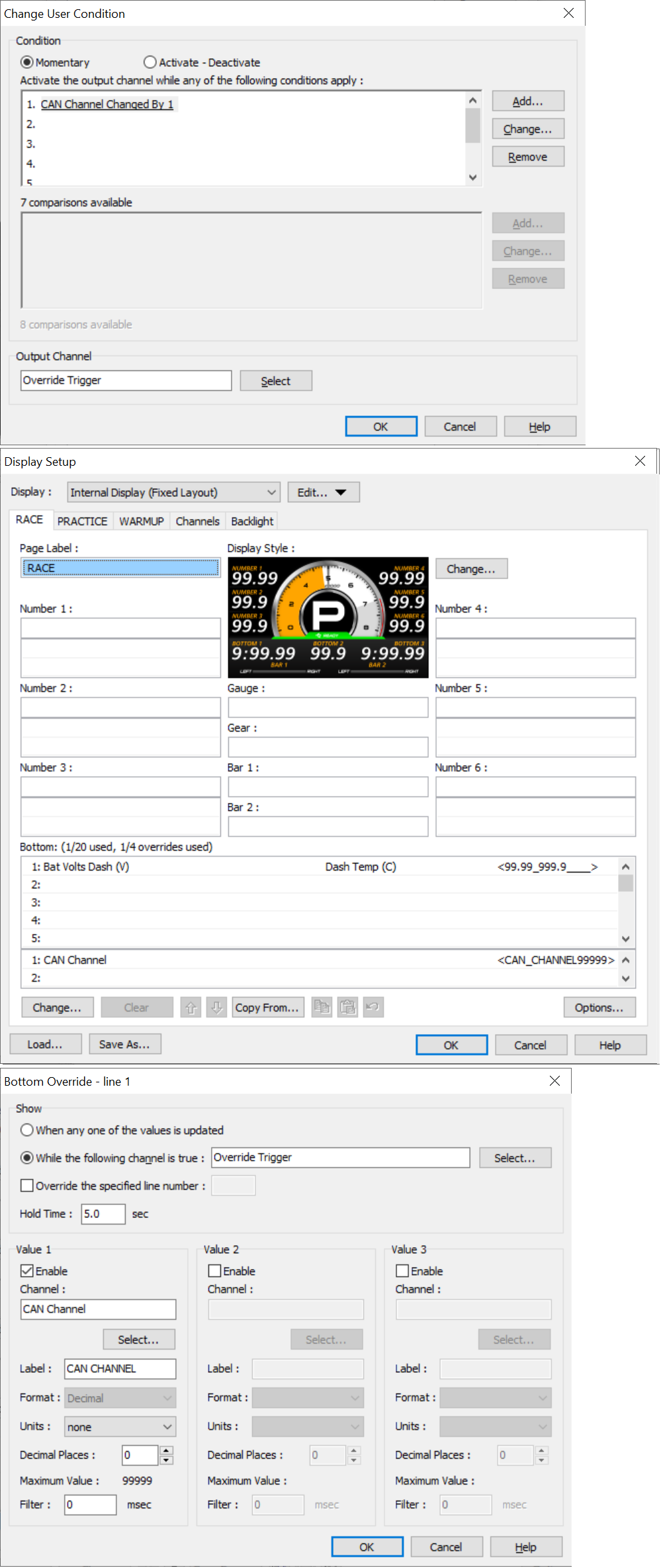

You can't use the 'Updated' function as a channel being sent on CAN is updated at whatever the rate the message is being transmitted at whether the value changes or not.
The way to do it will be to create a 'User Condition' that uses the 'Changed By' comparison and then put that channel in the override setup, see below:
Fixed Display Override - CAN Channel.png (323.15 KiB) Viewed 4304 times
Note: Changed By 1 will work even if the channel changes by some other value.
