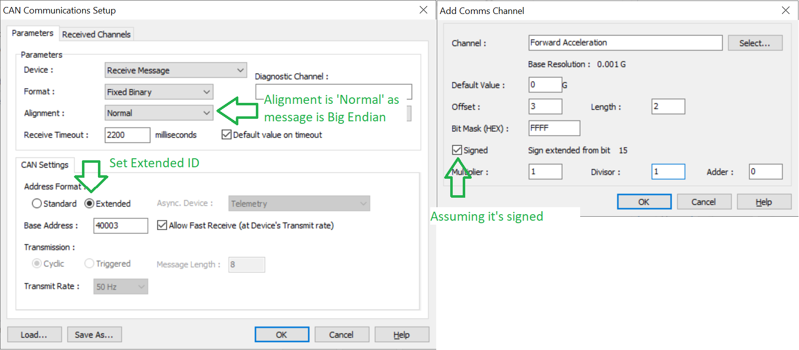

We typically use Big Endian (which is the same as that document) but reading in Little Endian is basically the same, you just set the alignment parameter to 'Word Swap' in the comms template.
Below is an example of how to setup 'Forward Acceleration' in the 0x0040003 message.
