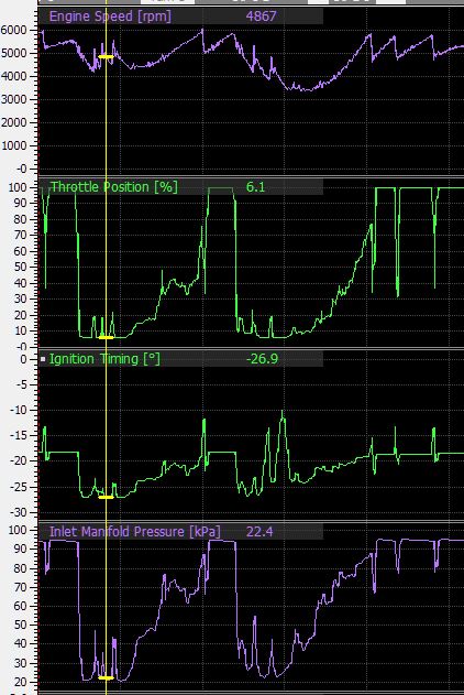

Is there a reason why the dash shows negative timing values all the time ? Logs shows negative values also.
Ex: 6000rpm WOT shows -25 instead of the actual 25 degrees. The ignition timing values are always negative on the display.

I went ahead and changed the display units but it is still negative. I also tried editing the ignition timing channel without any luck. No matter what I choose it’s still showing up as if it would be ATDC...

I can confirm that on a C127 running 6.13E firmware, that changing the display to show degrees ATDC or degrees BTDC does not change the sign of the Ignition Timing channel.
However, I2 does do this properly.

If you have a open 2d or 3d table you can create a new channel from ignition timing to display postive numbers. Its a temporary fix.
