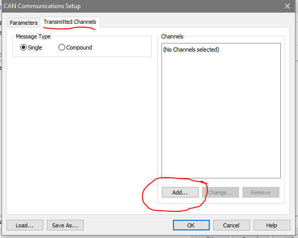

The Add button is found on the Transmitted Channels tab.
Add Button.PNG (13.18 KiB) Viewed 10196 times

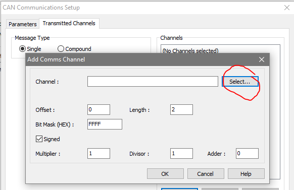

And the Select (or change if an existing channel is in place) is in the Add Comms Channel popup window.
Select button.PNG (16.64 KiB) Viewed 10196 times
