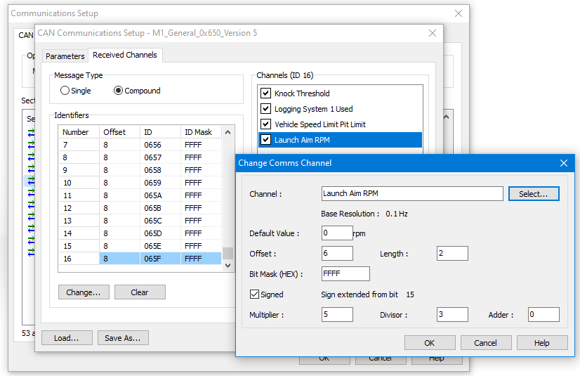

Hi Guys,
I've spent some of the afternoon poking around trying to get this right. The ECU (M130 GPR) is registering the Launch Engine RPM changing, however it seems the address that was given in a fairly extensive M1 canbus document, doesnt match. Can anyone confirm or tell me what address is required for the C12x(c125 in this case) to read Launch Engine RPM or Launch Aim RPM (same same).
I'm not exactly "super familiar" with finding canbus addresses that are not defined already so any input on where to start or what would make working this out, would be much appreciated!
Thanks in advance,
Chris
Launch Aim RPM.png (47 KiB) Viewed 11393 times

Which M1 Package and Version are you using? There have been some changes in the CAN Messaging out of the M1 in the later releases that required the Dash CAN templates to be updated. These are available in the latest releases of the Dash Managers and are marked as Version 5.

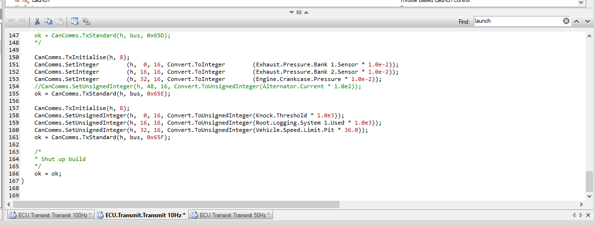

Can template: 0x650 Version 5, which I added the final channel to after finding it in the m1 can dbc that was posted up on these forums a while ago (Though I just realised, it's Version 4, not version 5). I've since pulled open the GPR Build package and can see that, the launch aim rpm / launch engine speed channels are not generated under 0x65F. Though my build version is potentially outdated (You emailed it to me a few months ago for tinkering / learning purposes)
M1 Build.png (48.23 KiB) Viewed 11371 times

Just looking through the code and Launch Aim Engine Speed isn't transmitted in any of the templates so it would need to be added into the code in M1 Build if you have a Dev license.
