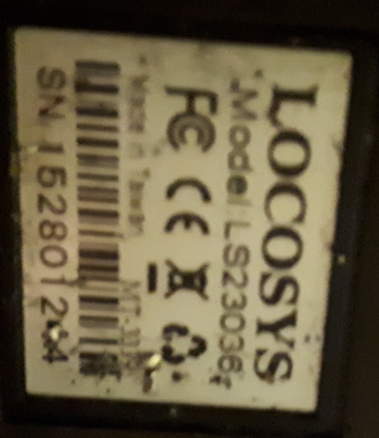

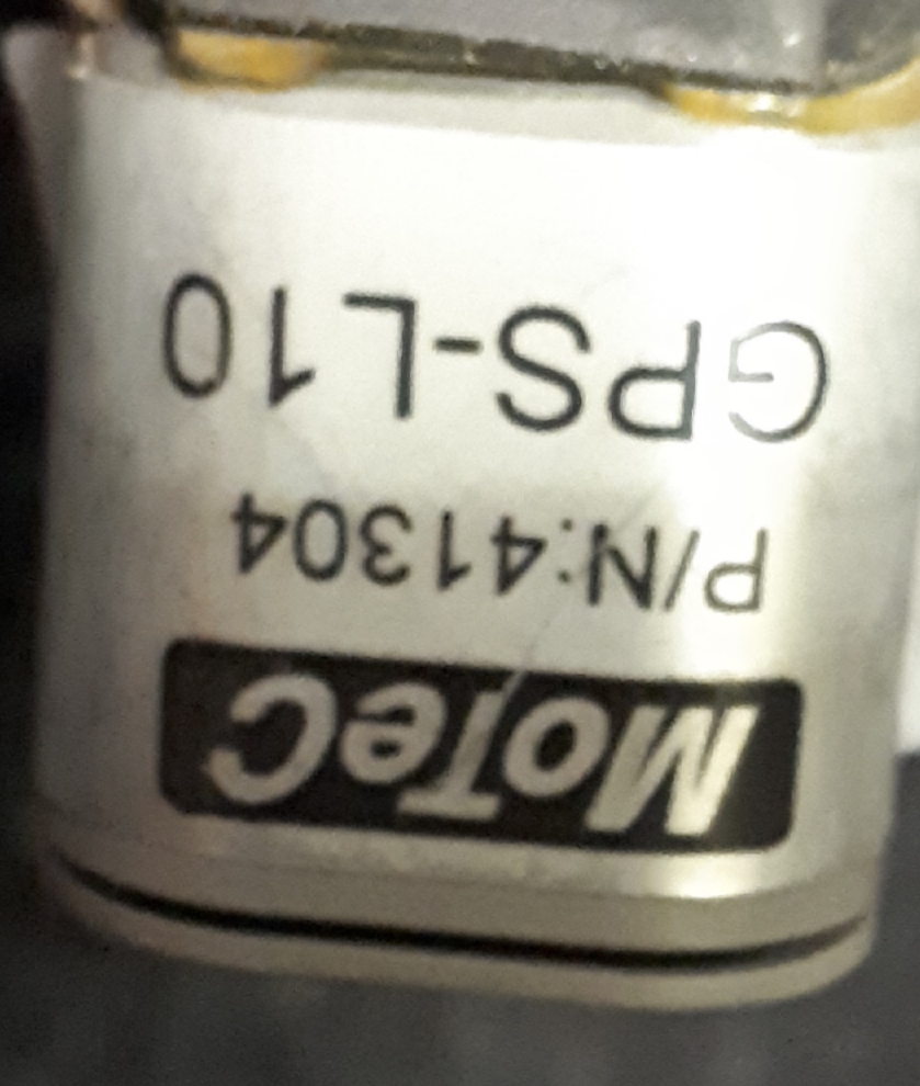

Postby Tom H on Sun Jul 21, 2019 7:07 pm
Thanks for the reply. The GPS unit is a L-10
I have attached a few photos, the label on the unit, the connector and the label on the connector.
what to check next?
gps connector
label on gps unit
label on gps connector

Re: C125 GPS Speed not working
Postby adrian on Mon Jul 22, 2019 9:33 am
If the light is flashing then it means that it has a GPS fix and is working correctly.
If you monitor channels in the Dash, check the channel 'Comms RS232 Diag'. If the value is 512 it means the Dash isn't getting any data and you have the Rx/Tx wires wired incorrectly. Make sure Pin 2 in the GPS connector is wired to pin 25 in the Dash.
