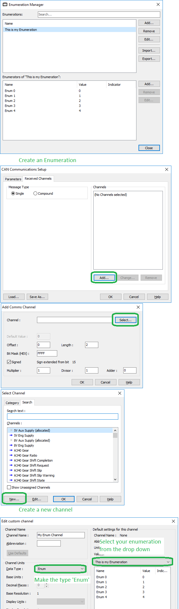

As for how it works, it is most useful when you are importing dbc files. If your dbc file contains enumerations they will be automatically added to the list and linked with the channels you are receiving.
If you want to manually add enums you can do that too. At the moment it will only work with channels you create yourself. Previously with Dash Manager whenever you set up a channel (say as an input pin or a CAN receive) you had to select a channel from a pre-existing list, however now you can create your own channels. If you make this channel an Enum then you are able to select an Enumerator to be linked to it (see below).
