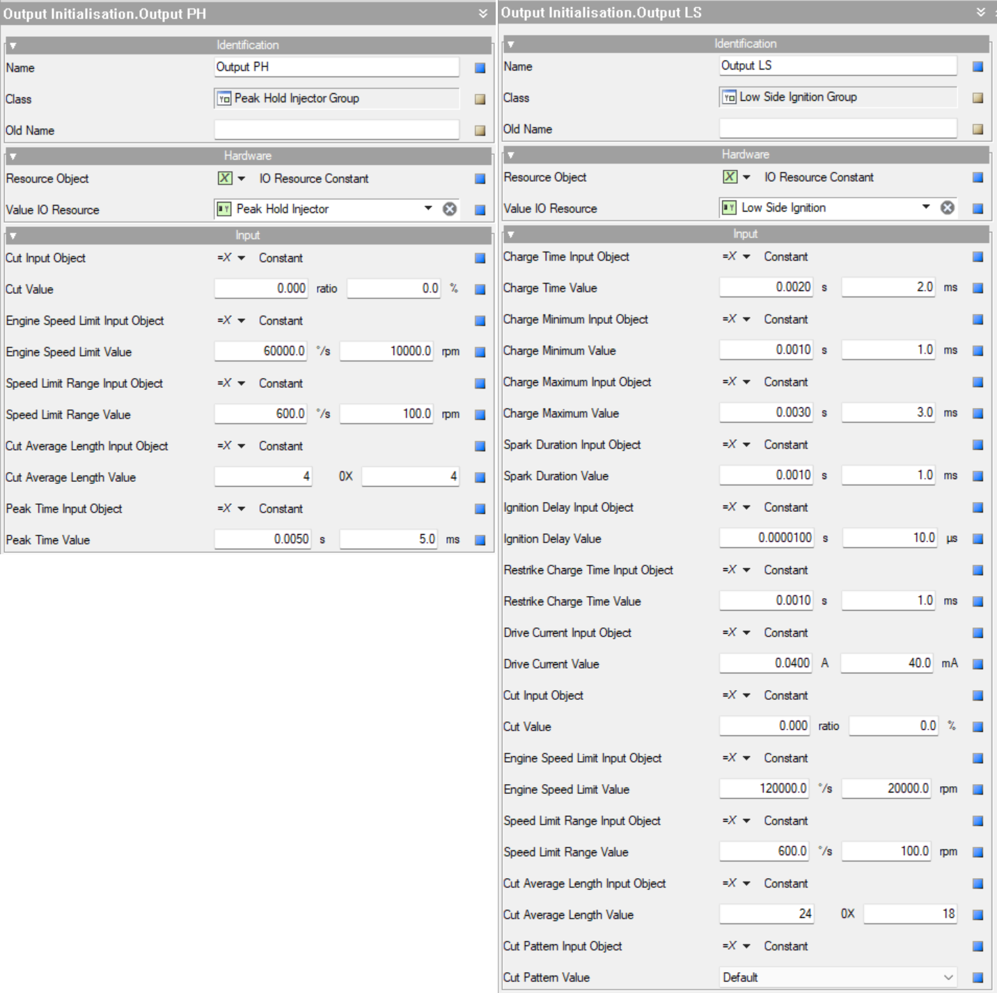

No, you have to add the hardware group classes to the project for those outputs to work. Below is an example of it done in a non-ICE project, if you set all of the configurable parameters to constants and you end up with only 3 channels for each group in Tune.
Output Config.png (22.96 KiB) Viewed 4883 times
Output Group Settings.png (277.29 KiB) Viewed 4883 times
