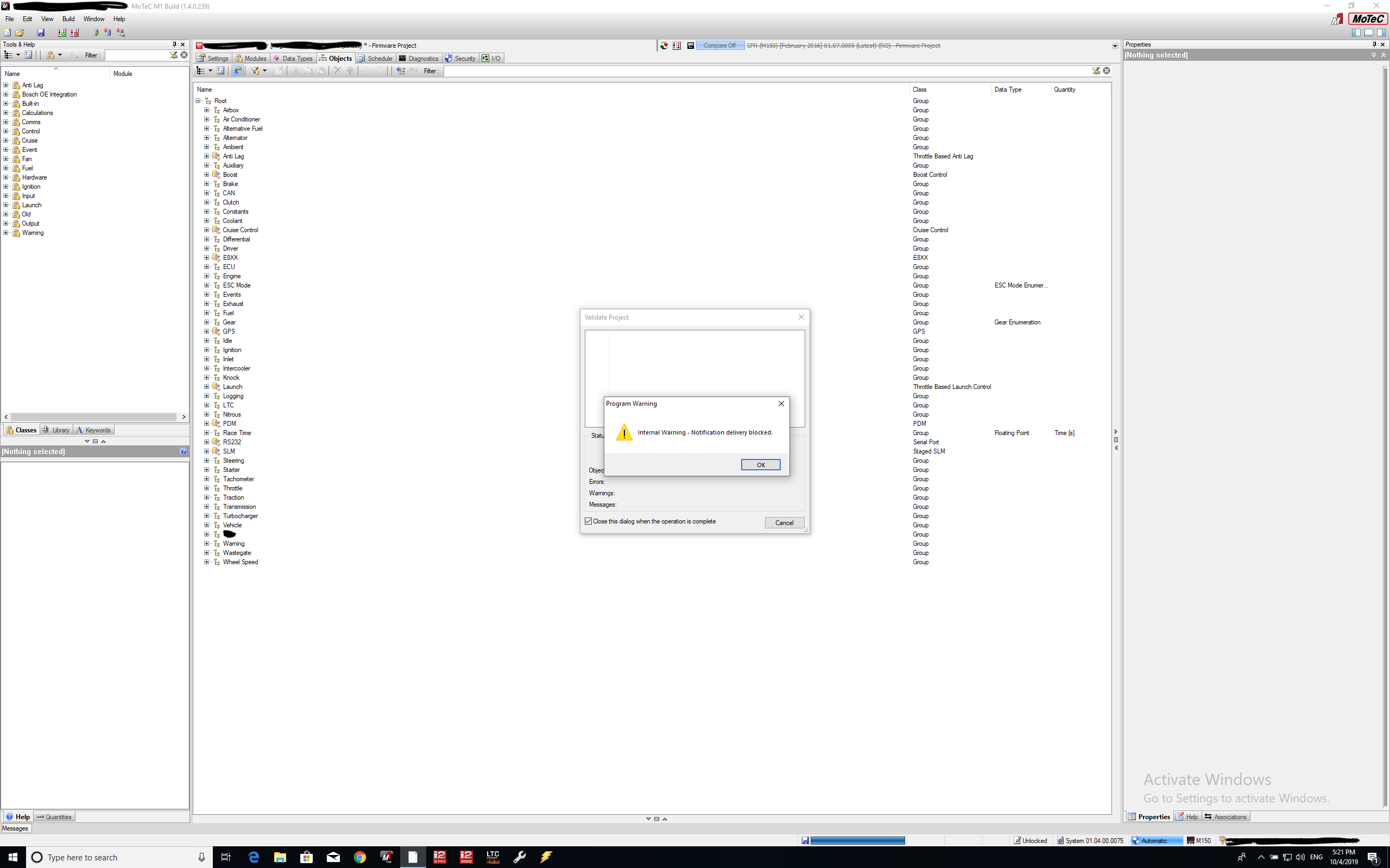

This package has been under development since 2017, and has been continuously updated, so starting from a new base file is not an option. I don't know which original version it started as.
I downloaded the newest build of M1 Build (1.4.0.239), and all of the previous errors went away, however, now when I try to validate the project, I get an error message pop up that doesn't go away after 100+ times clicking OK--I assume because there are 100+ warning messages. It says "Program Warning. Internal Warning - Notification delivery blocked."

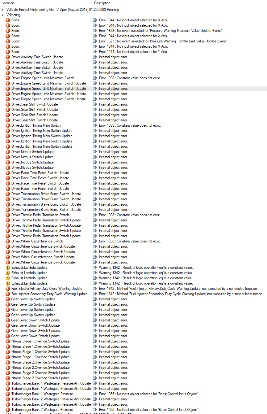

I ended up having to force quit the task with task manager. I tried again, but am getting all sorts of internal object errors and "Error 1038: constant value does not exist.".

Click on the boost object within your project, and have a look on the right hand side at the properties.
You will likely find there are items that either haven't been set, or are set incorrectly.
With the update of the boost module, there are additional items that need to be set in order to function correctly.
Incorrect settings in this object, will affect the rest of your project in the way that your screenshot shows.
