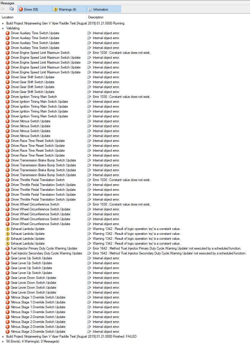

Postby aNinjaneer on Mon Aug 12, 2019 10:12 am
I changed back to the latest modules, and now I'm getting dozens of "internal object error" on many of the update methods, and "constant value does not exist" errors on many objects. Also getting errors for both primary and secondary fuel injector duty cycles "Method 'Fuel.Injector.[Primary/Secondary].Duty Cycle.Warning.Update' not executed by a scheduled function".

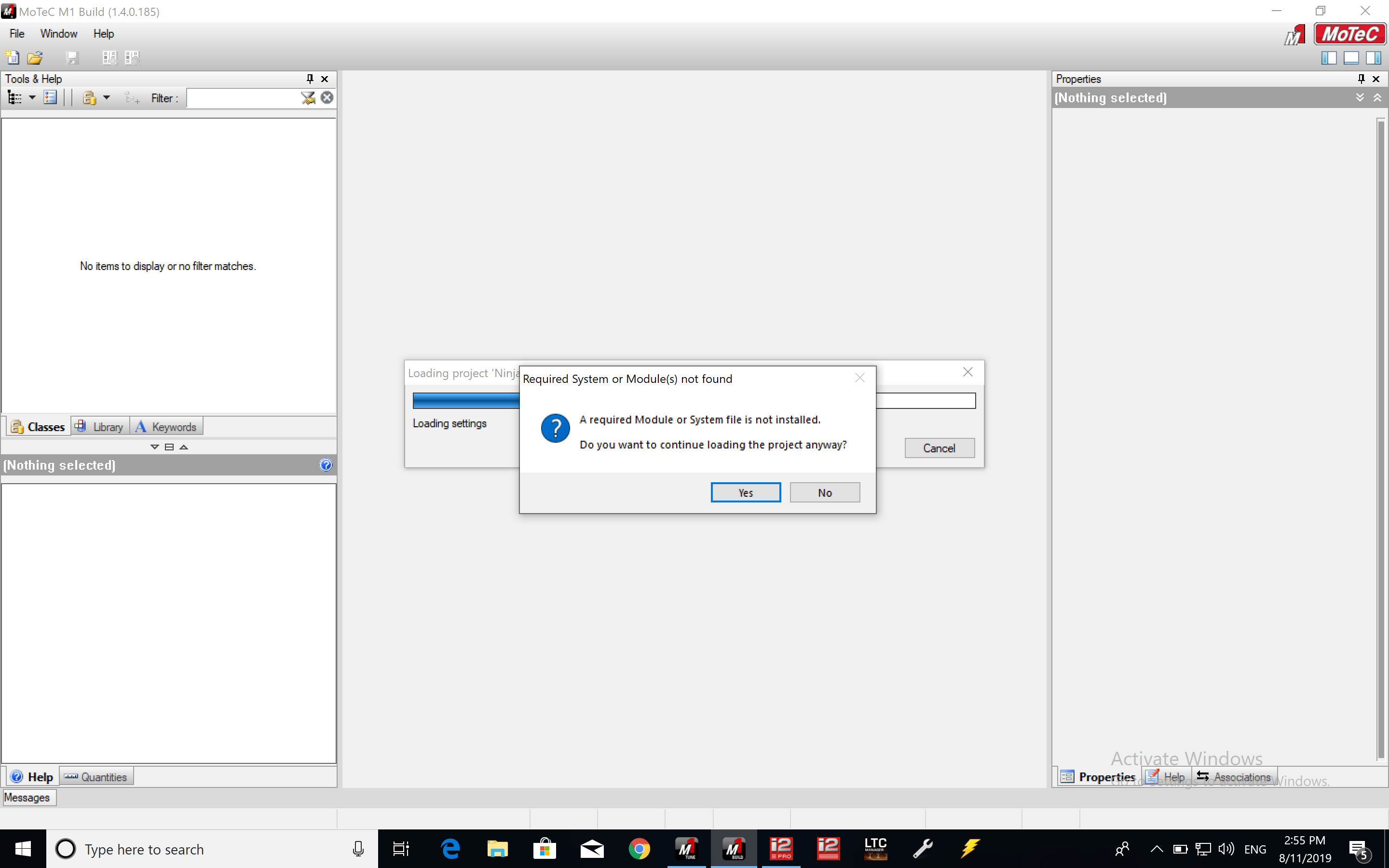

Postby aNinjaneer on Mon Aug 12, 2019 11:50 am
Here are the error messages I'm seeing after selecting values for all of the new axes and whatnot.
Screen Shot 2019-08-11 at 7.49.16 PM.png (217.86 KiB) Viewed 16633 times
Screen Shot 2019-08-11 at 2.55.59 PM.png (318.86 KiB) Viewed 16633 times
Screen Shot 2019-08-11 at 2.55.55 PM.png (223.8 KiB) Viewed 16633 times

Postby MalcolmG on Fri Aug 16, 2019 8:47 am
I realise this isn't helpful now, but I think it's generally good practice to avoid having any of your modules (or build system version) set to "Latest/Most Recent". I usually start a project with whatever are the most up to date modules and only ever update from there when I have a reason. Even if you really need to always have the most up to date modules in your project, I think it's best to upgrade in a controlled way (save and build your latest working version, then do an upgrade and if it all turns pear-shaped, revert to your previous build).
