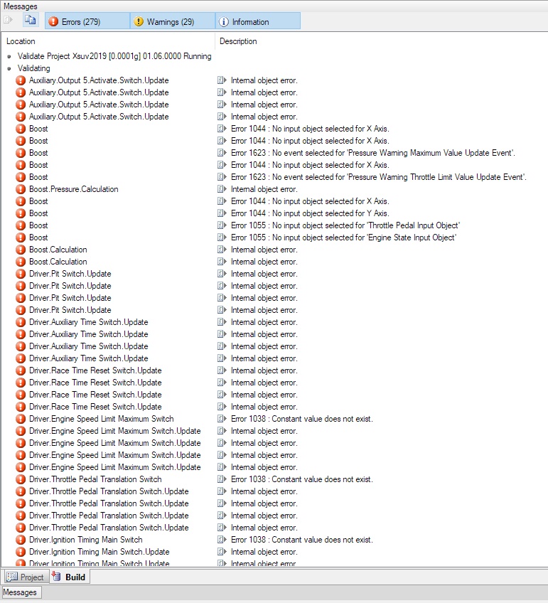

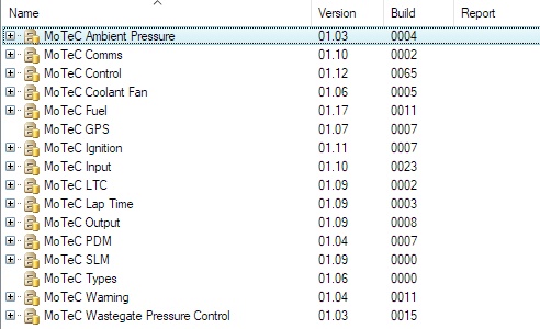

Postby Gaston on Mon Feb 18, 2019 8:25 pm
Hello Stephen,
I´ve installed your modules version now... and looks the same for me. (i am not an expert on M1 build)
I attached pictures.. and my file , which is just a GPA where i am "removing" functions i dont need .
You can see last build "g" is with last version modules you´ve sent... previous are with older modules and no errors.
Xsuv2019.m1prj-archive
(7.39 MiB) Downloaded 1561 times
new modules installed list .jpg (58.38 KiB) Viewed 18693 times

Hi Gaston,
Looking at the project you uploaded, the errors being reported are legitimate.
You are using the latest Boost Module, which requires events to be selected for new items.
You will see in your project, that if you click on the boost module in the objects tab and scroll down within the Properties box, there are event items that are not selected.
There are also several other items not selected, such as the throttle pedal input and engine state input.
You will need to review these errors and fix. (this is not the same as the original errors you had reported)
