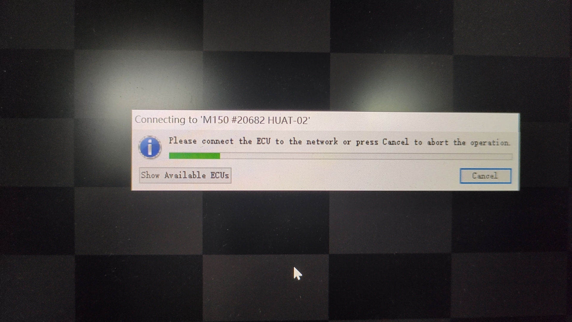

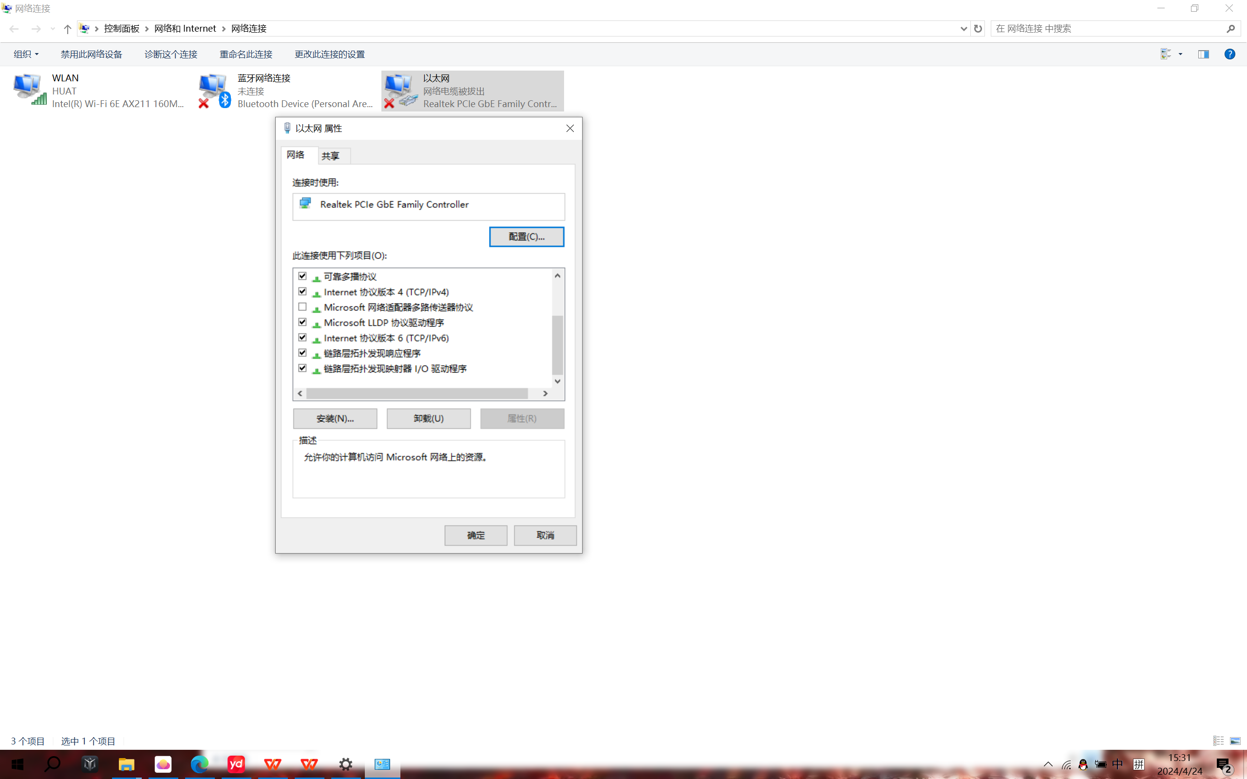

I have an M150, when I use Ethernet to connect the M150 to my computer, the Quick Launch says my M150 has been detected, but when I use the mouse to click on the ECU icon, it keeps stutting, I have turned on IPV6, and my computer can turn on C125 normally.
I think there's something wrong with my computer because I can turn it on when I use my friend's other computer.
I am very upset because I can't use M150 normally, so I would like to ask about the possible problems of my computer, thank you!!!

In M1 Tune, can you go to View | Show Messages and View | Show ECU Monitor, and clear each of the windows that come up by right clicking on the window and selecting Clear. Once this is done, try to connect to the ECU again and then copy the messages that are posted in the two windows. Paste these into a document and then sent it through to support @ motec.com.au
