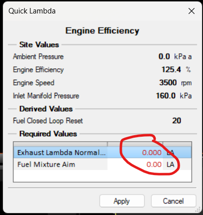

It is not possible to open the log file in M1 Tune, this is opened in i2. You have to manually transfer the data from i2 into M1 Tune to do this.
You find the location in the logging that has a discrepancy between the Fuel Mixture Aim and Exhaust Lambda Normalised, you then match this location by Engine Speed and Manifold Pressure to the nearest cell in M1 Tune.
Once this is found and clicked on, press the Q button to bring up the Quick Lambda function. Enter the Exhaust Lambda Normalised and Fuel Mixture Aim values from the logging in the highlighted areas and then click OK, this will apply the changes to the Engine Efficiency table.
