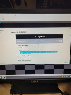

We found the problem. it was a bad firmware version.

Yes,
We did not discover that the system version 94 had a bug with the HPFP until the Monday morning, at which point it was removed from MoTeC Online.
Glad you were able to get everything resolved.
