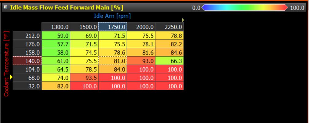

We currently have the following values for the feed forward tables, after doing a couple of startups with this new custom throttle area table. I've really only tuned the 1500-2000rpm columns since changing over to the new table, while the rest of the values were roughly guessed/interpolated from the other well-tuned sites.

This is with our Throttle Aim Maximum setting at 12%. I fear moving the throttle aim maximum value up much higher, as doing so will likely worsen throttle pedal feel and idle mode transition, wouldn't it?
Obviously if I were to increase it to say, 15% it would allow me to decrease the values in the feed forward table to a more reasonable/tunable value, rather than being right at the limit of 100% at 20 degC. In my current state, I would actually want greater than 100% feed forward values in the 0 deg C rows. This is obviously not possible, so I'd need to either increase the Throttle Aim Maximum value, or find a correct throttle area table, correct?

A 40mm throttle open to 10% will flow a lot less mass through it than an 80mm throttle at the same percentage opening. A very quick calculation shows that the 80mm throttle will flow around 4 times as much mass as a 40mm at the same angle. This is a reason why just going larger on a throttle can sometimes be a backwards step in the behaviour of an engine.
I have found that a higher value in the Idle Actuator Throttle Aim Maximum can actually improve the transient response of the throttle into and out of Idle Control, as well as the operation of the Idle control, as it provides a larger window for the system to operate in. If the number is too small, it creates harshness in the responses.
