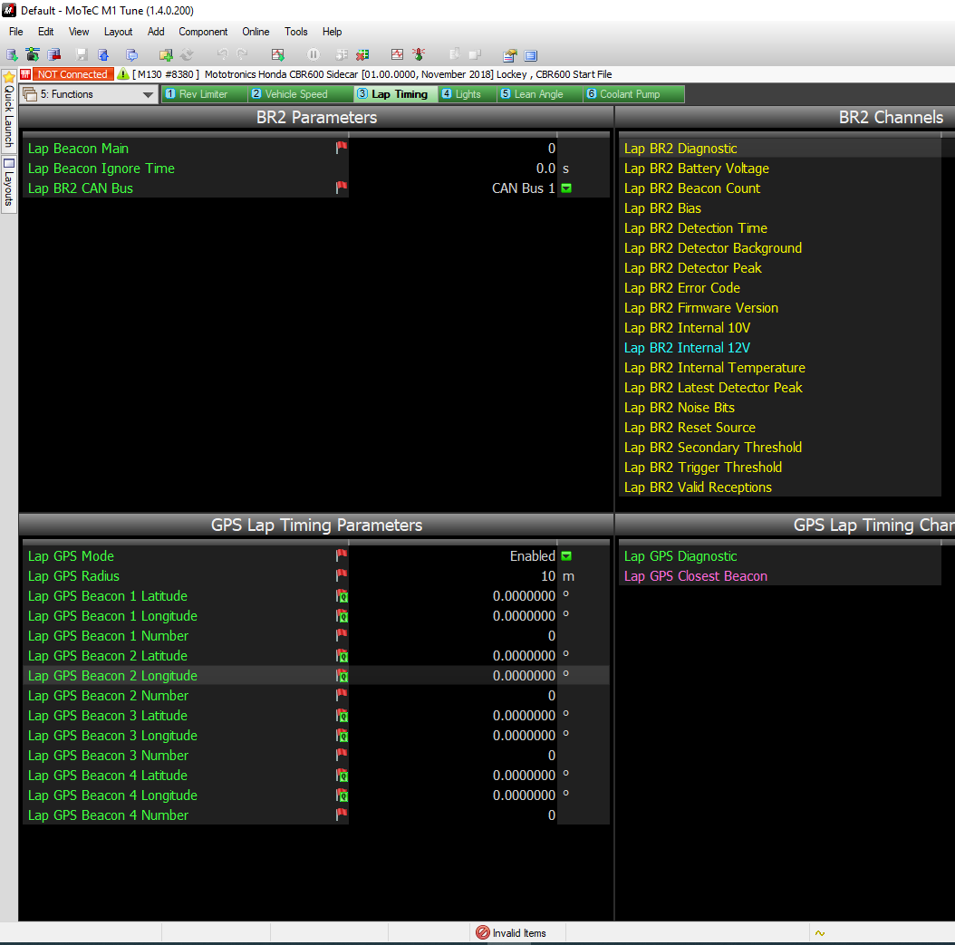

Postby benmtech on Wed Sep 23, 2020 5:23 am
Please see attached - not sure I have done this correctly.

Postby David Ferguson on Wed Sep 23, 2020 7:46 am
I would disable the BR2, by setting Lap BR2 CAN Bus to "Not in Use".

Postby Stephen Dean on Wed Sep 23, 2020 10:01 am
Hi Ben,
The Lap GPS Beacon x values are used to allow for a set of custom beacons to be used with the M1, the co-ordinates for all of the tracks that we have data for (matches that in the Dash software) is embedded into the M1 firmware and will automatically detect the correct beacon when the GPS co-ordinates align.
Are you running the GPS directly into the M1, or is it coming in from a external device, such as a MoTeC Dash? You need to ensure that the GPS Valid channel is reading as Valid, if it isn't then the Lap function will not work.

Postby benmtech on Wed Sep 23, 2020 7:07 pm
Thanks Stephen.
The GPS Channel is VALID in the data so I think that Mallory Park in the UK is not on the circuit database. The GPS is coming from a CDL3 on ID's 680-683. So as I understand it I should put the start/finish line coordinates in "Lap GPS Beacon 1 Latitude" and "Lap GPS Beacon 1 Longitude". Am I correct in assuming that I can still use the remaining 3 beacons for splits? If so how does it know which is the start line? Does that need to ne number 1?
