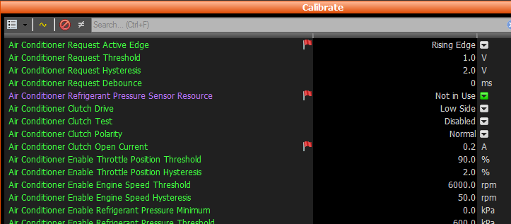

Not correct Mark. See screen shot.
The other box is removed and the throttle pedal signals only go to the Motec M150 ECU. This other box was going to be used for cruise control as I have asked and asked for cruise control to be added to my package. I keep been told it was too dangerous to let the user make sure there was a clutch and brake switches and only OEM's were capable of doing this every time. My cruise control box is now completely unplugged.

What part of the screen shot shows that I am incorrect?

Postby rayhall on Mon Aug 05, 2019 2:04 pm
That screen shot is from AC Control settings and it mentions
AC Enable Throttle pedal Threshold and Hysteresis

Postby MarkMc on Mon Aug 05, 2019 2:14 pm
Ok,
Your original question was:
"When the engine is idling and the AC is turned on I loose the throttle control. Just like when you have a broken throttle cable. What setting cases this to happen, and why."
There is no function that stops the DBW when the AC is on as I stated. The screen shot shows the parameters for turning the AC off based on throttle position, e.g. turn the AC off under full throttle to save power.
