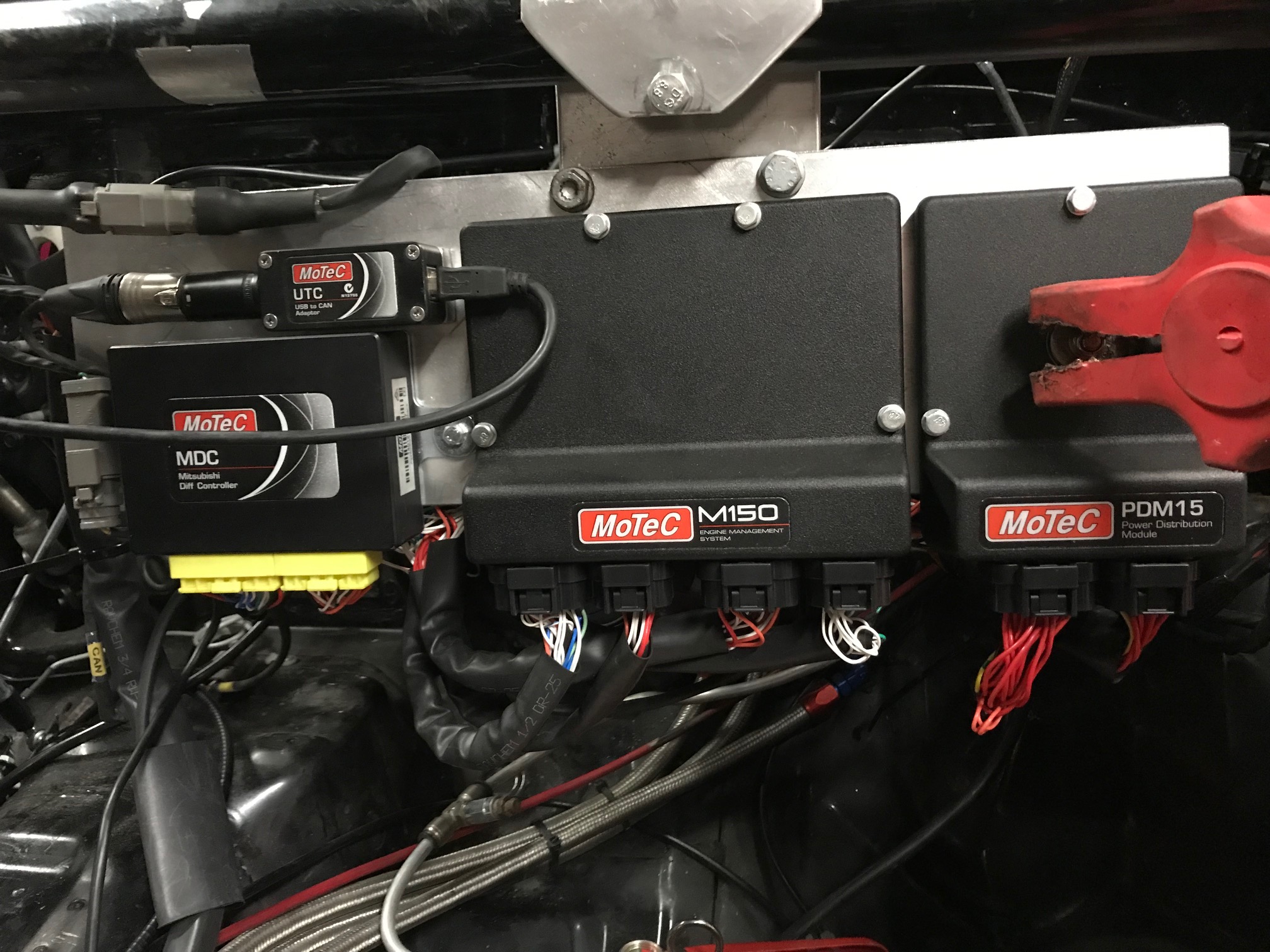

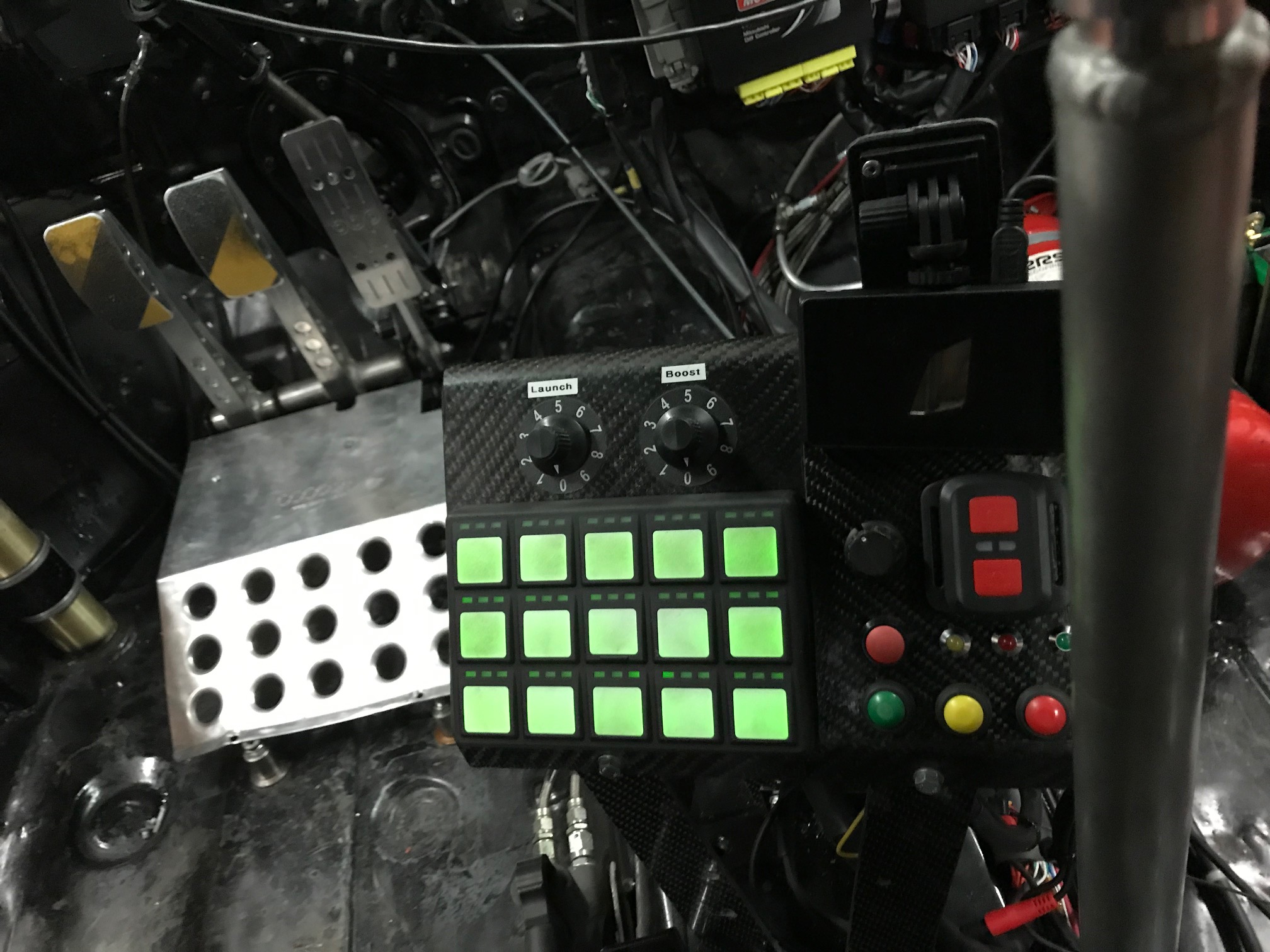

The setup is: M150 - MDC - PDM15 and a 15 button keypad, all on the same CAN bus. Firmware GPRP
What we want to achieve: M150 gets signals from MDC (wheelspeeds, etc.). Some of the keypads should control actions in the PDM and some should control actions in the M150.

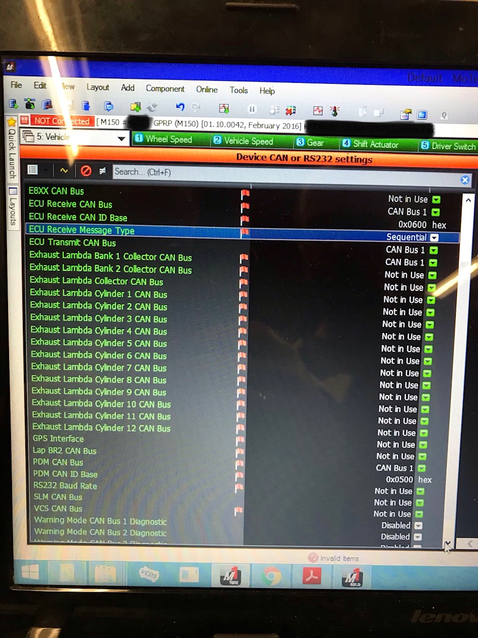

We have set the ECU Receive CAN ID Base to 0x1F4 to receive the messages from the MDC. ECU Receive Message Type is Compound. (Please ignore the settings in the picture attached, that was just for a test).
We have set the PDM CAN ID Base to 0x540.
With this setup we can receive messages from the MDC and also the PDM standard signals.
To forward keypad messages to the MDC we have created User defined messages in the PDM. But how can we get access to those in the MDC? In the drop down list of the available input signals there is nothing related to PDM User Defined messages. After doing some research it appears we would need a Dash to receive the PDM User Defined messages and send it to the M1. Is this really the only way? Spending another 2k just for that?
Or do we have a general problem in our setup and what we want to achieve is simply not possible?

There is not support in the M1 Firmware for the MDC/SDC units, if you have a M1 Build licence you could write a receive template for the channels into your custom firmware using the information provided in the MDC Manual.
What are you trying to send through to the MDC from the PDM Keypad? The notes that I have for the mode switch into the MDC show that it is an analogue signal from the switch that essentially toggles the mode counter up with each press and then rolls over when it reaches the maximum value.

We are not trying to send keypad buttons to the MDC but to the M1 ECU. We can control things in the PDM obviously but we would also like to send some of the buttons directly (or indirectly via the PDM) to the ECU. All that has probably no relation to the MDC but I wanted to mention it as I thought it may cause complications.

You can transmit the PDM Keypad messages from the PDM to the M1 using the PDM CAN Outputs.
