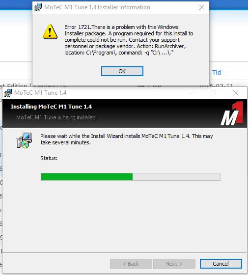

Hey this is what i get.
i have had this issue before, one year ago when i tried to install in on my other home pc.
it at the final stage of installation.

Can you verify that these two directory structures are in place and that they both contain two files called MoTeC.Archiver.dll and MoTeC.Extract.exe
C:\Program Files\MoTeC\Archiver\1.0
C:\Program Files (x86)\MoTeC\Archiver\1.0
Re: M1 Tune - Error 1721
PostPosted: Mon Apr 08, 2019 11:32 am
by Stephen Dean
It appears to be an issue related to the Swedish language version of Windows, where the directory path is truncated to C:\Program in the registry, and the installer is unable to find the required files to continue the install.
Unfortunately we can't control this at our level as it is being done by Windows.
This is covered in this forum post;
https://www.motec.com.au/forum/viewtopic.php?f=66&t=3000
