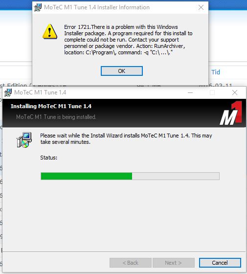

Postby karel021 on Fri Apr 05, 2019 9:34 pm
Hey this is what i get.
i have had this issue before, one year ago when i tried to install in on my other home pc.
it at the final stage of installation.

Postby Stephen Dean on Mon Apr 08, 2019 10:35 am
Can you verify that these two directory structures are in place and that they both contain two files called MoTeC.Archiver.dll and MoTeC.Extract.exe
C:\Program Files\MoTeC\Archiver\1.0
C:\Program Files (x86)\MoTeC\Archiver\1.0
Posts: 1856
Re: M1 Tune - Error 1721
Postby Stephen Dean on Mon Apr 08, 2019 11:32 am
It appears to be an issue related to the Swedish language version of Windows, where the directory path is truncated to C:\Program in the registry, and the installer is unable to find the required files to continue the install.
Unfortunately we can't control this at our level as it is being done by Windows.
This is covered in this forum post;
https://www.motec.com.au/forum/viewtopic.php?f=66&t=3000
Posts: 1856
Postby karel021 on Wed Apr 10, 2019 8:50 am
Epic that worked well !! super thanks :)
