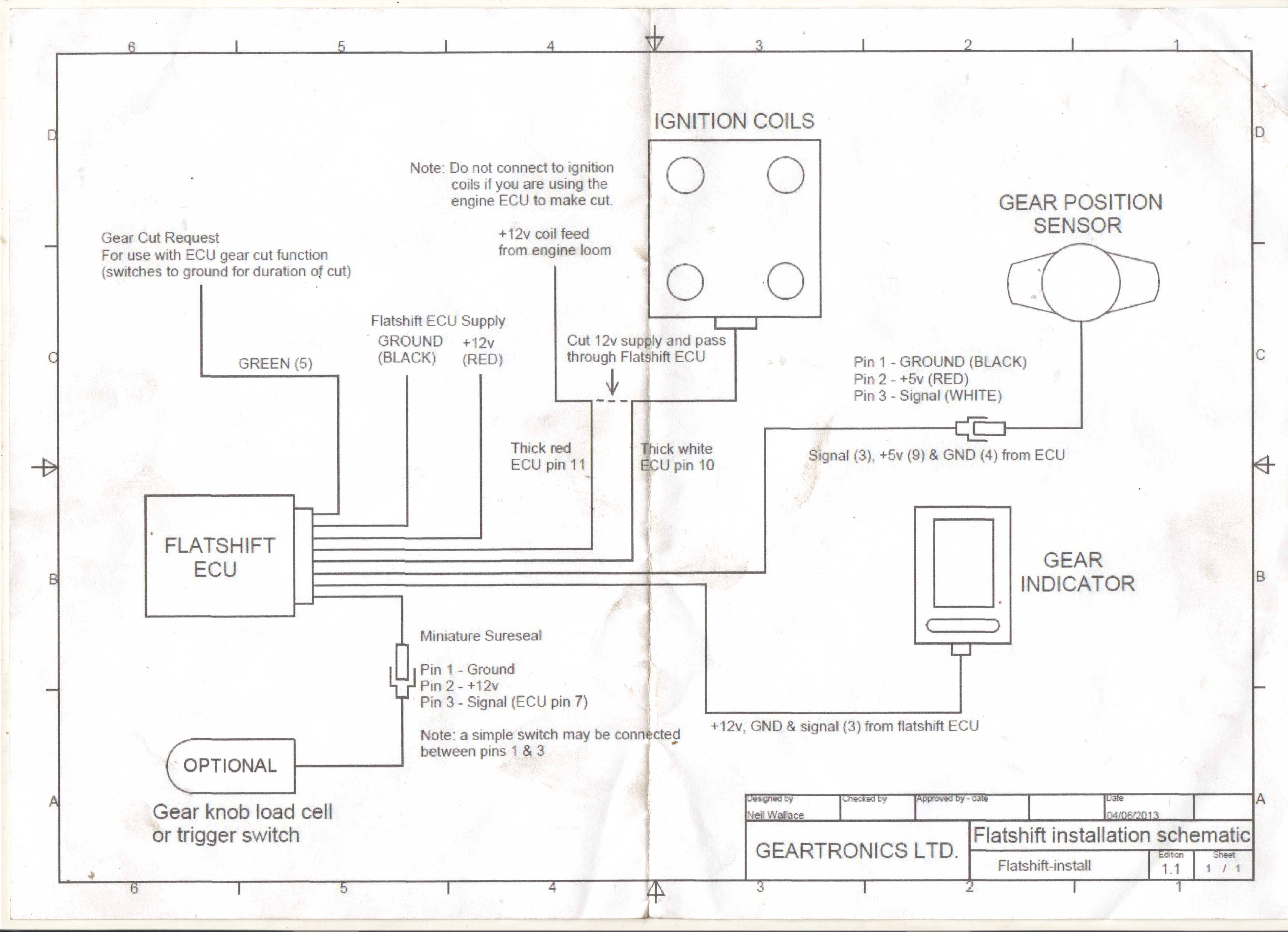

I would like to install Saenz sequential transmission using M130 with Honda F20 engine.
The gearbox came with a solenoid for throttle blip for down shift.
It connect to flat shift wiring harness, 2 wires label blipers from the flatshift ecu.
How to connect all these with the M130 ?
This is the diagram from the Saenz transmission below :
Saenz Transmission.jpg (843.11 KiB) Viewed 5925 times
Really appreciate for any reply.

Hi Everyone and Loqy,
We thought about doing blippers but they are not a great solution overall so we always recommend putting Drive by Wire throttles on as they are a far superior solution to a number of functions.
