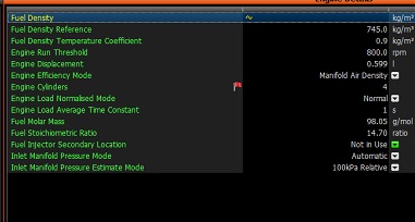

Hi everyone,
Im from a Formula student team and we have just moved to M150 from M800. The team runs a Honda CBR600RR engine with a 2cm restricted intake. We run a Bosch Tmap sensor on the intake and stock denso fuel injectors with Fuel save 98(Shell). While calibrating the engine efficiency table, the values seems to be too high. I do not know what I have done wrong. I feel that the fuel injector calibration maybe wrong because I am not able to find the exact model number on the default options given by M1 for a cbr600rr bike. Could someone help me with this.
Engine charge cooling - 12 deg cel
Fuel calibration.jpg (51.68 KiB) Viewed 28751 times
initial set up.jpg (23.41 KiB) Viewed 28751 times

They are just numbers -- if that's what the engine wants then it's OK. It's not unusual to see values like that at particular RPMs where the intake and exhaust resonance produce a pulse that helps stuff more air into the cylinder.
If you want to have your injectors calibrated by MoTeC and added to the M1 pull-down list then you need to arrange to send them in through your MoTeC dealer.
A way to check your injector calibration is to vary the fuel pressure and see if the Lambda output remains constant.
You can also try changing the Fuel Mixture Aim Main and seeing if it achieves the desired mixture (however there are other factors that may cause this not to be correct, including Engine Charge Cooling Gain that you mentioned).
However for calibrating a single engine, that you don't expect to be changing injectors (or if you do, you would revisit the tune), then just building the Efficiency table with what it takes to get a good result will be perfectly fine.
BTW -- telling us what the part number of the injectors you have might allow someone to provide a calibration.
