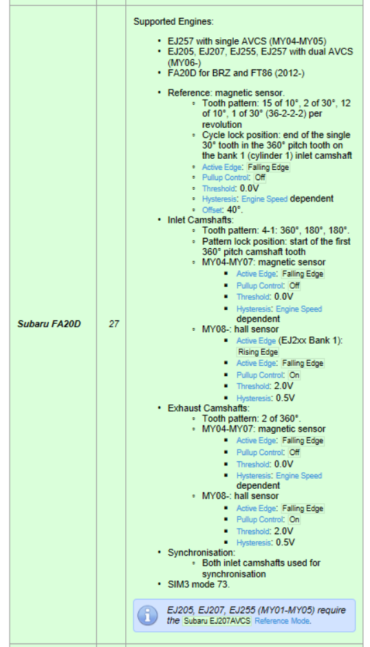

I would use the settings for the MY08+

We used the setup you sent, it keeps giving bad sensor.
Engine is 2007 not 2004. We use the front cam as Engine synchronization pin and the rear for cam inlets bank 1 and bank 2,
I saw some people saying we should use the synchronization pin on back on of them.
Car is runing fine, but problem with AVCS .
Camshafts teeth of 2007 is different with 2004
Any advice? .

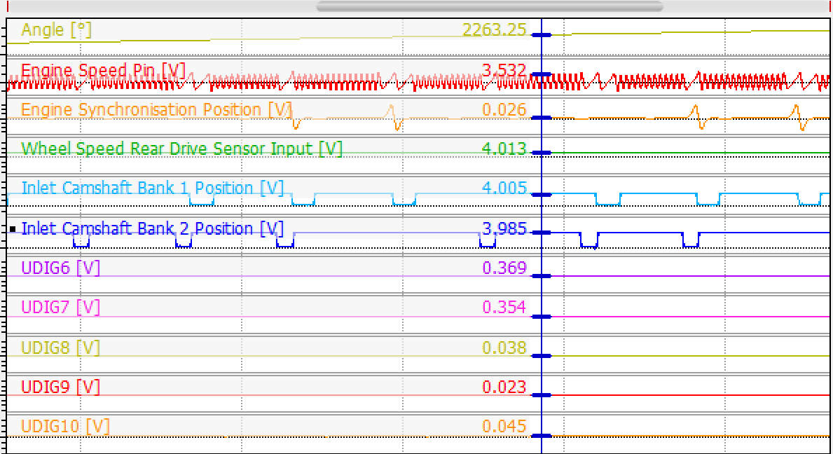

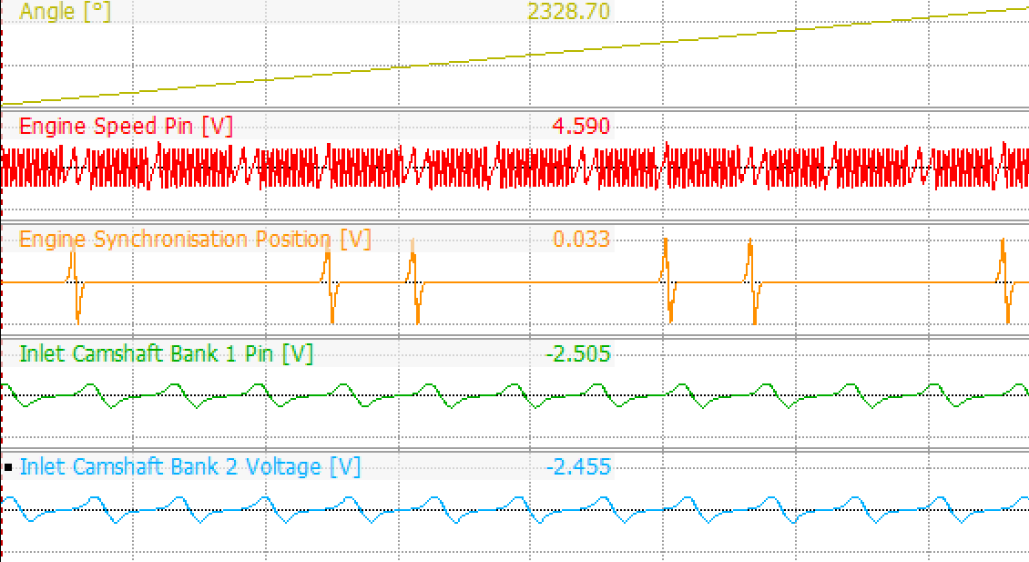

I have attached a Input Capture from a Early EJ207 that uses the EJ207AVCS Reference Mode, as this has cams with 4 equally spaced teeth and Mag sensors. You have a 4-1 tooth pattern on your cams, which is used in the FA20D Reference Mode. You can disable the Sync input and just use the Inlet Cams.

Attached your capture with our capture to compare, the capture on cam inlets is different.
Check the captured pictures we attached .

Postby Stephen Dean on Wed Nov 01, 2023 5:01 pm
That is correct, My Capture uses the EJ207AVCS Reference Mode with the four evenly spaced Inlet Cam teeth and Mag sensors. Yours uses the FA20D Reference mode with the 4-1 Tooth pattern and Hall sensors.

Postby ammar.alqisie30 on Wed Nov 01, 2023 6:56 pm
So, should we change the Engine speed reference mode to FA20D ?
ammar.alqisie30
Posts: 24
Joined: Mon Jul 03, 2023 9:42 pm
Re: Subaru 2007 Ref Sync needed
Postby Stephen Dean on Thu Nov 02, 2023 8:47 am
Yes.
