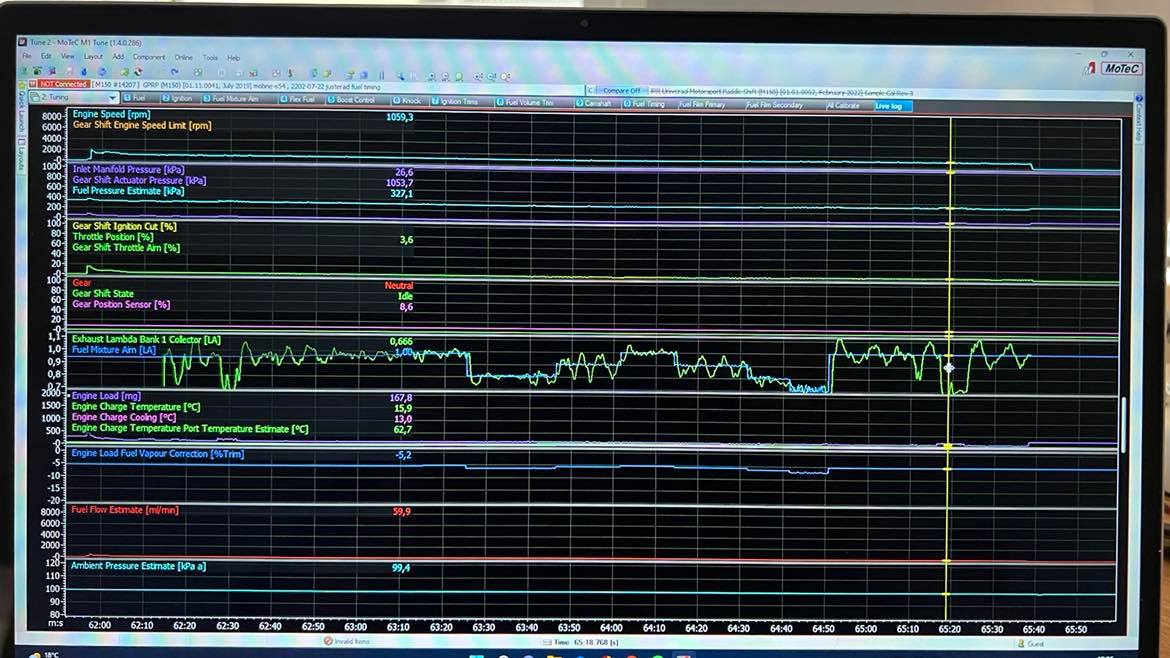

I don't know if this helps at all but i have a picture of the fuel monotoring page and one over the live log at the pointr where i press q. I post it for you.
The sections before i try change the lambda target to see how it follows and the lambda struggle to hold the aim.

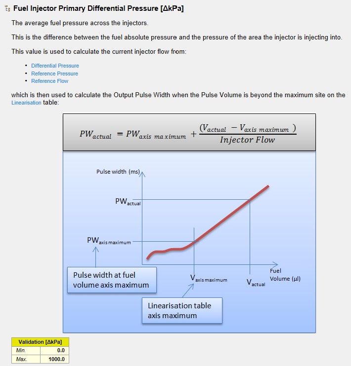

The reason you think there is an issue with you injector calibrations is in part due to the fuel pressure differential value. This is calculated based on your injector location:
After throttle: Fuel pressure (measured or calculated if no sensor value) - inlet manifold pressure
Before throttle airbox referenced: Fuel pressure (measured or calculated if no sensor value) - airbox pressure sensor
Before throttle boost pressure referenced: Fuel pressure (measured or calculated if no sensor value) - boost pressure sensor
the idea being for the before throttle use on estimate based tuning is that because we don't have a reliable pressure signal to reference being on the other injector, we use a reference value other than inlet manifold pressure. If it was set to after throttle in estimate based tuning, the differential pressure would change every time a value was changed on the estimate table. As your set to boost pressure relative, at light load, the differential pressure is not calculated accurately in your instance, as you have a high (indicated by your manifold pressure sensor) manifold vacuum at idle.
fp differential.jpg (83.47 KiB) Viewed 5215 times
In the case of your particular application, the next steps I would take are the following:
- Unassign your inlet manifold pressure sensor (this will fix your Q function issue)
- Assign the inlet manifold pressure sensor to airbox pressure (you then have this value available to you for monitoring manifold pressure)
- Set the Injector location to "Before throttle airbox referenced" (so the differential pressure of the injector is correctly calculated against the inlet manifold pressure)
- Retest behaviour.
I noticed that you also have some atypical numbers in some of your fuel volume and fuel film trim tables, so just be mindful of that (particularly the fuel film ones when tuning)
