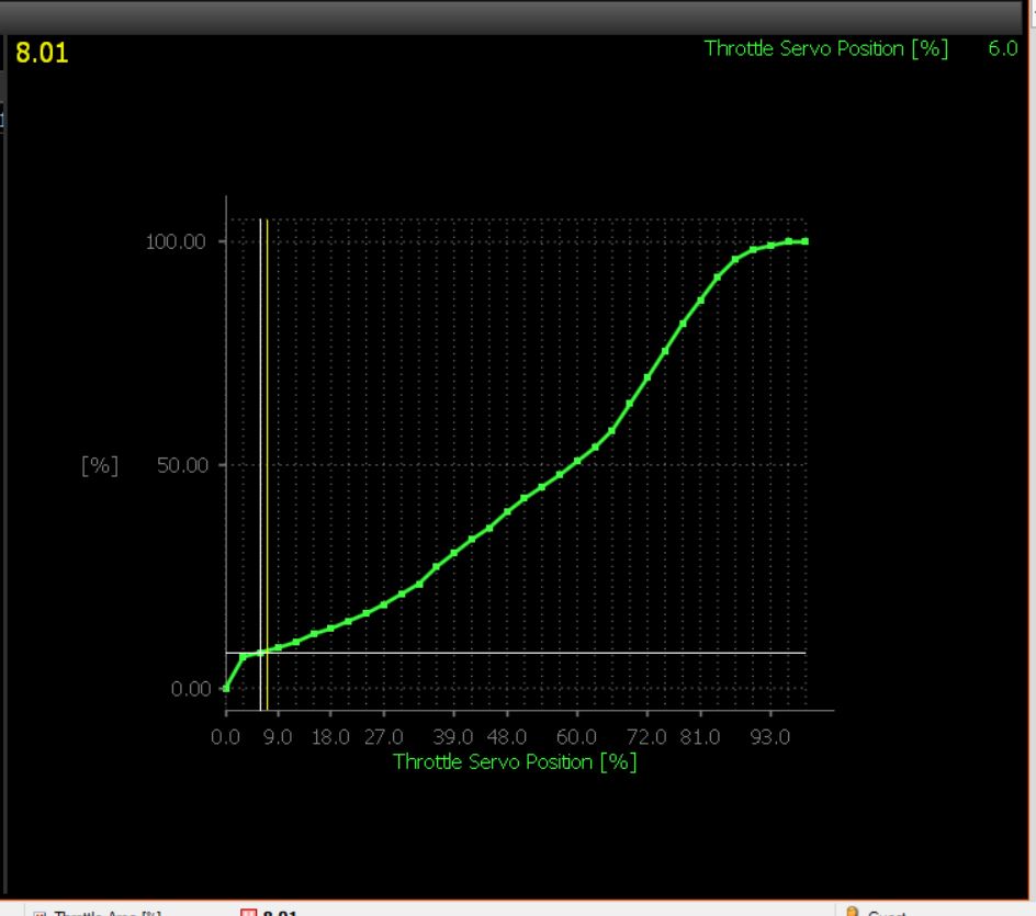

In order to try and get the throttle area table correct, I decided to put the throttle body on a flowbench and measure the flow rate of air through the TB at all the servo % positions listed in the table. After compiling the results into the table, I ended up with this is a resultant graph.
Throttle Area Graph flowbench results.JPG (75.22 KiB) Viewed 11298 times
I am doubting the accuracy of this method, as the overall curve does not look logarithmic like I believe it should. I thought I would try to tune with this new throttle area table anyways, just to try it. I don't believe it could be accurate, as I needed to have the feed forward values set to 100% at 68 deg F coolant temperature, and only down to about 75% at full (hot) operating temperature.
It would seem apparent that the values in the throttle area table are over-stated and would need to be decreased to lower the feed forward values to a more reasonable level of control
Is there a better way to tune each throttle area % for each throttle servo %? I cannot wrap my head around how physically flowing the throttle body like I've done could be wrong.

I know a few teams that have done a similar process with the Throttle Area table, and have ended up reverting back to the base table as the drivers have complained able the feel and driveability of the throttle with this change. Some throttle bodies are also scalloped to make a more linear mass flow through the body as well.
The Idle Mass Flow Feed Forward Main numbers are a percentage of the Idle Actuator Throttle Aim Minimum parameter, what is this set to in your Package?

A 40mm throttle open to 10% will flow a lot less mass through it than an 80mm throttle at the same percentage opening. A very quick calculation shows that the 80mm throttle will flow around 4 times as much mass as a 40mm at the same angle. This is a reason why just going larger on a throttle can sometimes be a backwards step in the behaviour of an engine.

Playing around with tuning the feed forward table, searching for appropriate Throttle Aim Maximum values, and making adjustments to the throttle area table have led me to find the general trend that in order to keep the feed forward tables at reasonably low values (so as to not exceed 100% feed forward values with the idle mass integral control still trying to add more air).. it seems as though dropping the values in the Throttle Area table (at least up to about 25% Servo position) keeps the system happy.
I've read a few threads online now and talked to a couple of local tuners who use MoTeC that have actually suggested that I just set the Throttle Area table to a 2-point linear graph 0 to 100 (linearly interpolated). They have then said that the pedal feel can more easily be tuned using the pedal input to servo output translation table, rather than trying to do this with the Throttle Area table. What is your opinion on this?
Would there be any noteworthy drawbacks to setting the Throttle Area table linear like this, specifically would it cause any negative effects on idle mode transitions, and engine deceleration back into idle control? Any input is greatly appreciated.
