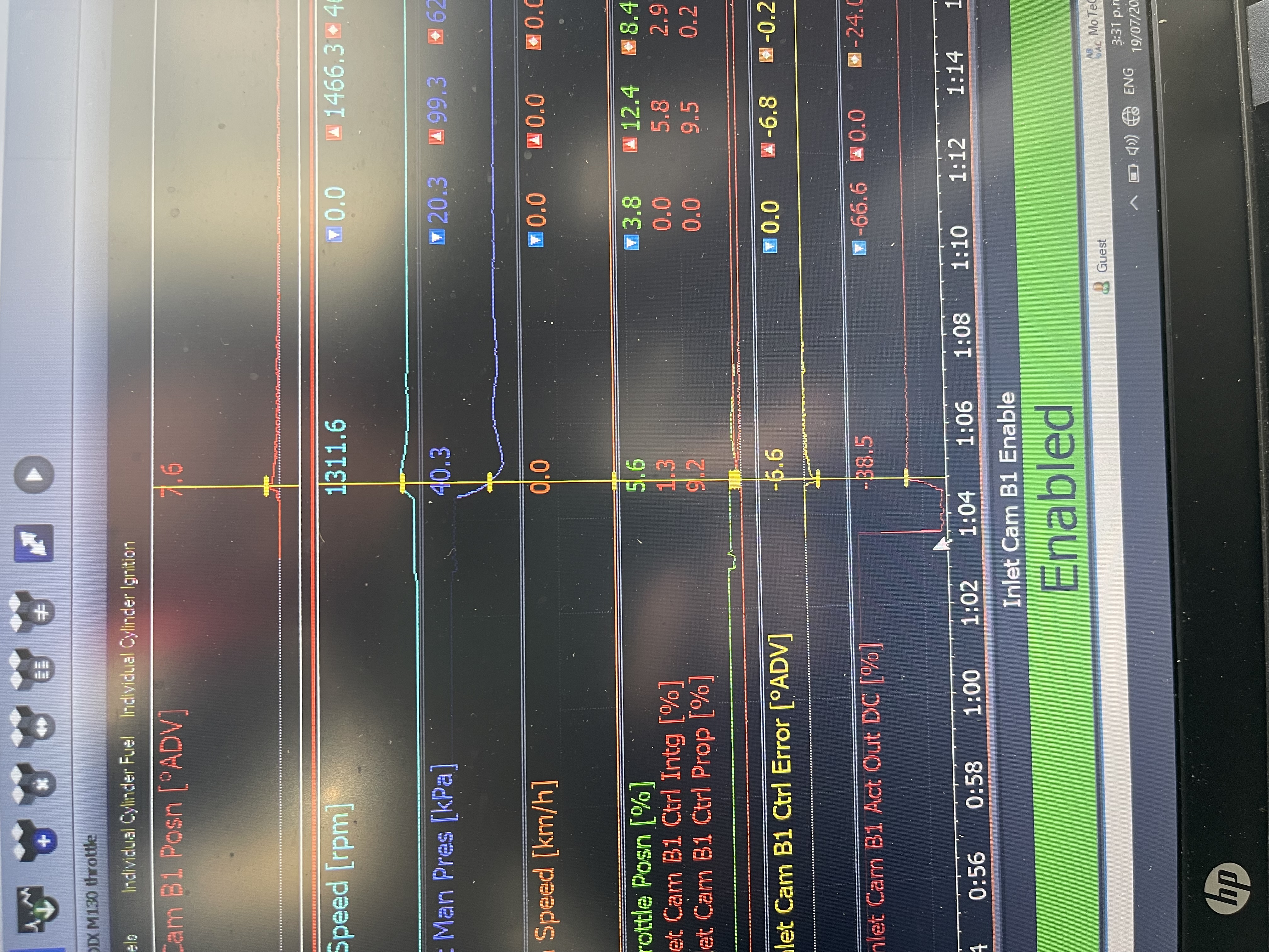

I am getting Inlet Cam drive output during cranking and where Cam Aim is zero.
Engine is Honda K series, with the cam driven with the high side of a HB.
I have heard elsewhere that this issue doesnt present with the Low side driving.
Is there a setting I have missed or is this expected behaviour? I see a startup delay has been introduced to the GPRP Pro

Can you post a copy of your package and a data log during cranking. The picture above shows the engine idling already. It looks like the Aim changes, so of course you would expect the actuator DC to change to try an meet the Aim. I suspect you just haven't made sure the Aim is always zero in the cranking and initial start zones.
So perhaps it's doing exactly what you ask, but not what you want.

Postby 4ttl on Sat Jul 19, 2025 4:20 pm
I have replaced the cam gear with a new one as the common startup rattle was concerning.
The odd behaviour continues. Screen shots of cranking behaviour. It seems as soon as the channel is enabled the system pulls duty into the output regardless of position.

Postby David Ferguson on Sun Jul 20, 2025 4:31 am
We really need to see the Inlet Camshaft Aim, (actually all the parameters under Inlet Camshaft). I suspect that table has an advanced value at cranking RPM, when the MAP is close to ambient pressure. When you are starting, the proportional or integral setting are trying to move the cam, or maybe the Inlet Camshaft Bank 1 Control Feed Forward is set to zero. Studying your package would allow us to suggest solutions.
