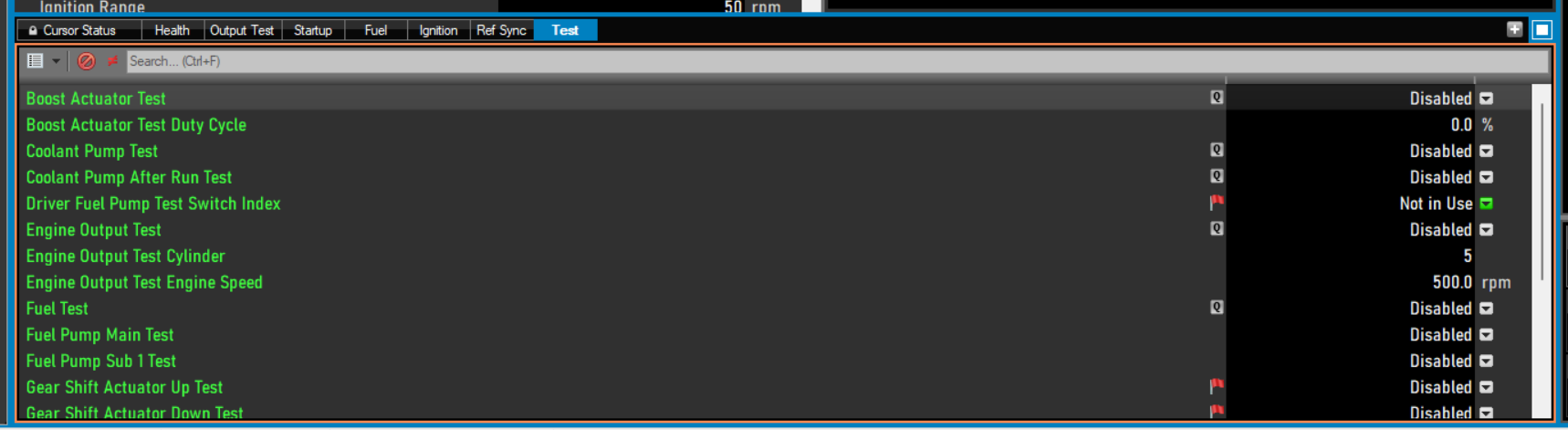

With the dynamic nature available with Tune 1.5, I decided not to try and assume where an output test would be required for certain tasks.
Tests in dashboard.png (133.54 KiB) Viewed 1939 times

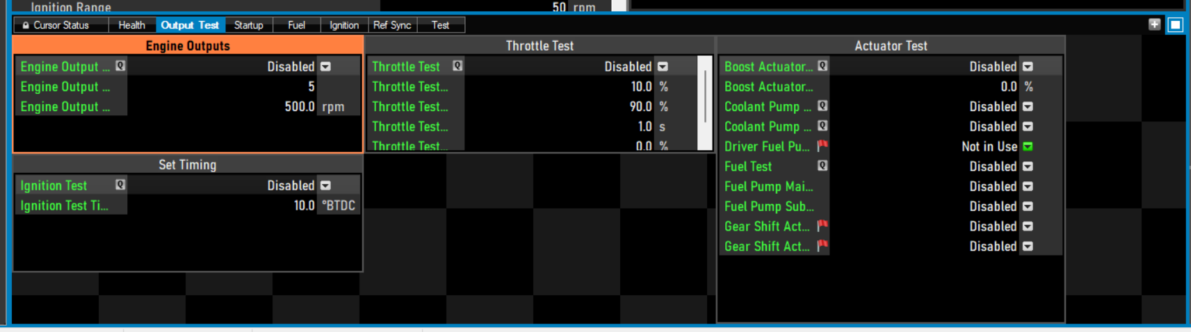

As such I implemented 2 test pages in the dashboard to cover most test use cases.
Test page 2.png (124.52 KiB) Viewed 1939 times

I think I understand. So with a MoTeC General based Workspace, select Adjust->Workspace->Engine Setup / Ref Sync, then select the "Output Tests" or "Output and Actuator Tests" tab in the monitor window (called Common Telemetry in the User Guide, and "Dashboard" in your description) at the bottom of the worksheet. Now I can see the Engine Speed Ref / Offset in the Adjust Items list and have control of the Ign Test and Ign Test Timing parameters.
I just need to start looking for those Telemetry/Dashboard/Monitor combinations. Thank you for the graphics indicating where to look.
