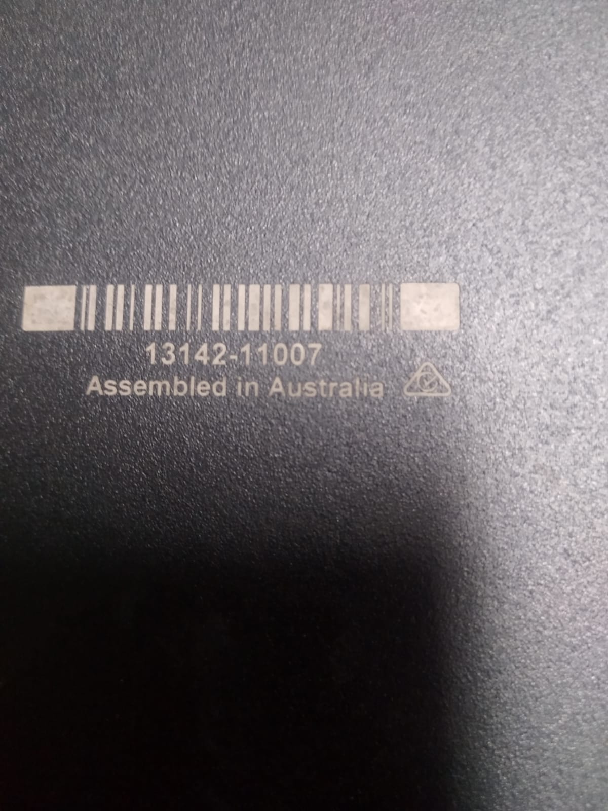

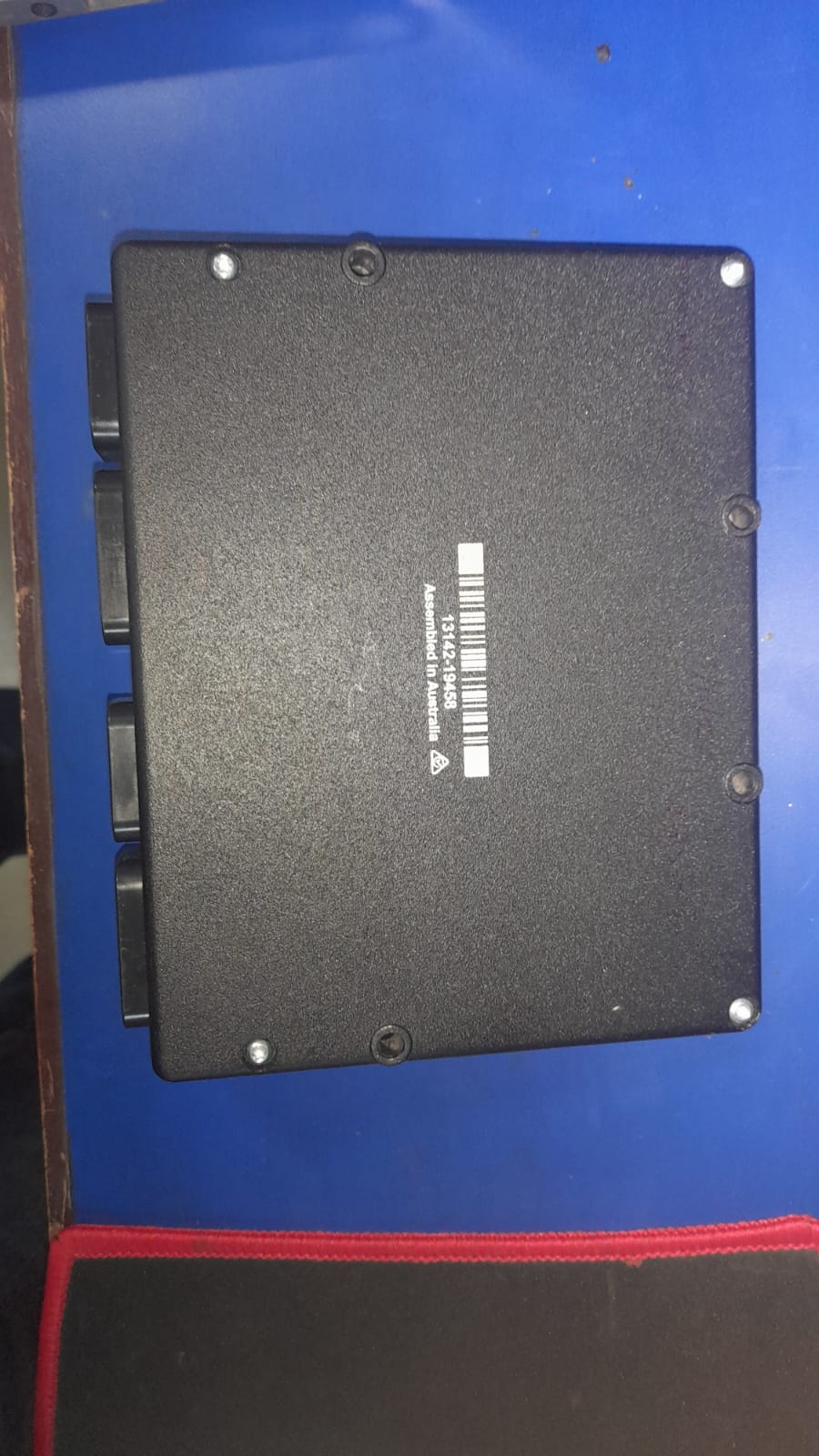

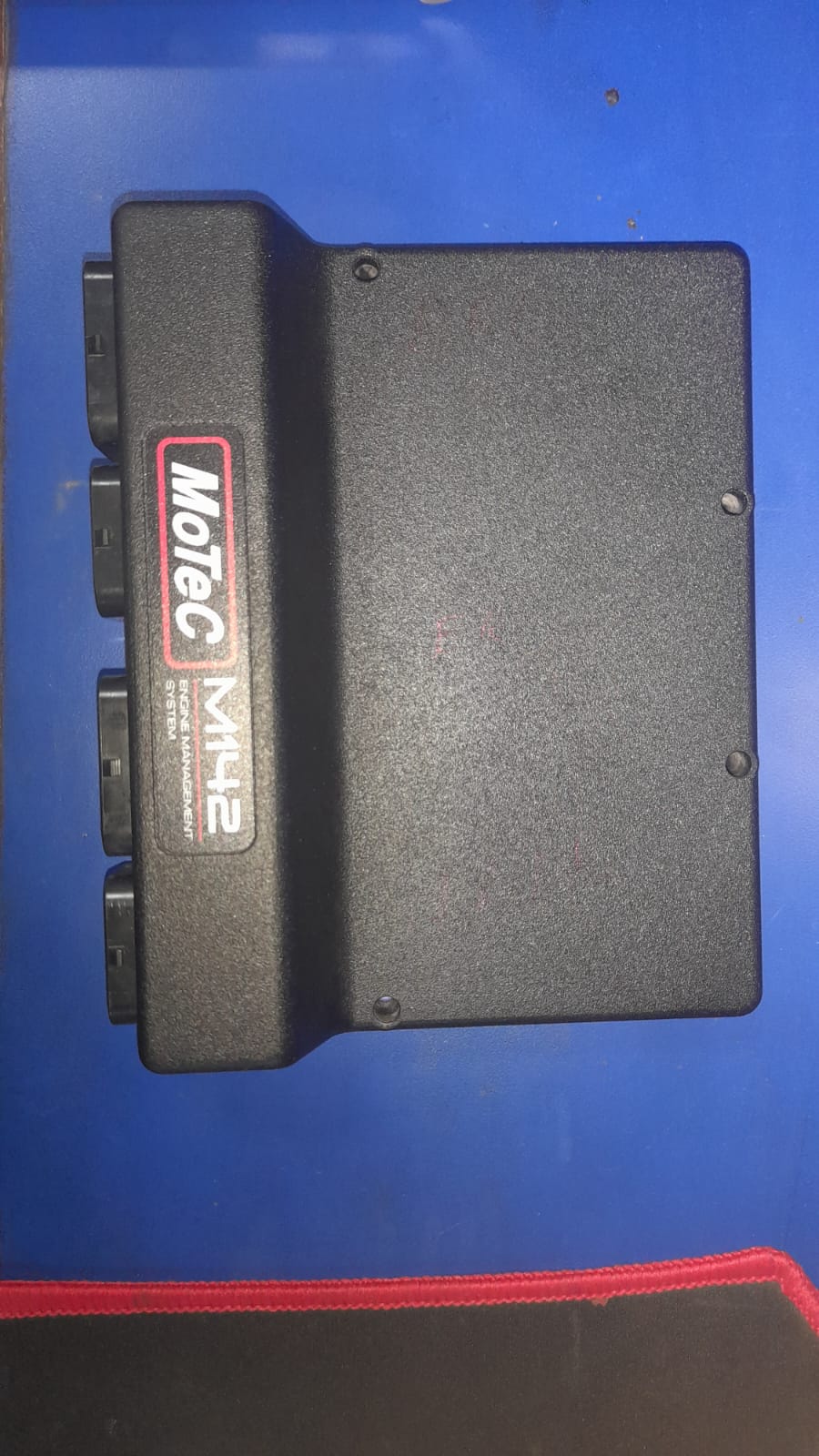

Postby dhanu on Tue Apr 11, 2023 11:27 pm
Dear Sir,
for GPRDI, the Sr. No: 13142: 19458
for GPR Diesel: 13142: 11007
I have attached the photo's of both of the ECU.
Dhananjay
