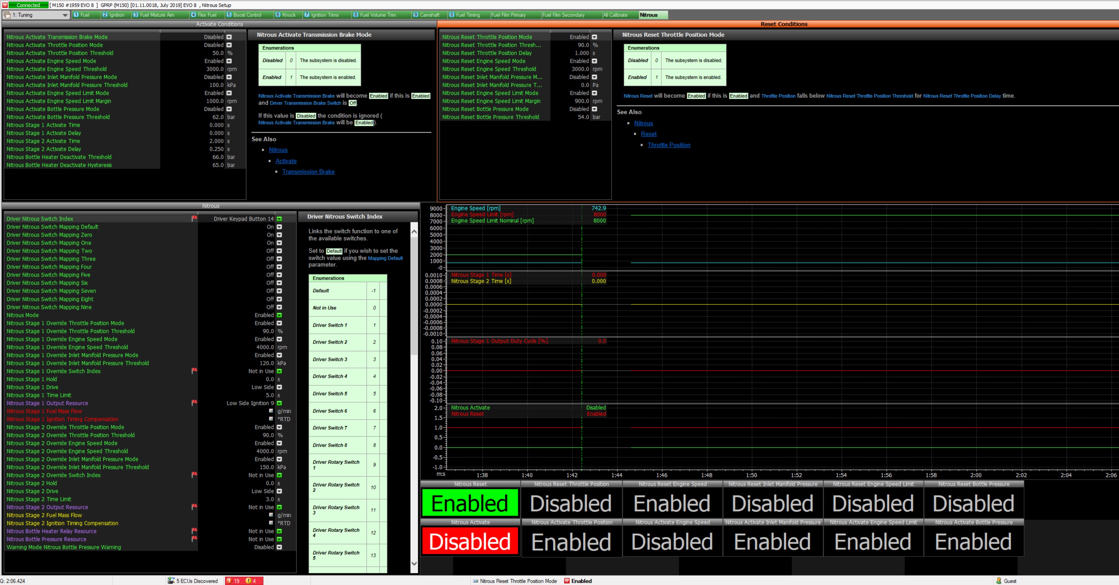

The activate parameters are responsible for the nitrous activating. ALL of the enable parameters that have been setup, as you can see below all the activate conditions are met except for engine speed, which means the nitrous is not active.
GPRP - Nitrous not active.jpg (1.24 MiB) Viewed 3791 times
Once all of the activate conditions are met, and none of the reset parameters are met, the nitrous will activate (inline with any delay and time limit conditions.
GPRP - Nitrous active.jpg (1.21 MiB) Viewed 3791 times
The reset conditions are what turn the nitrous off. The reset name is a little bit misleading. If any of the reset conditions are met, the reset will enable, disabling the nitrous.
GPRP - Throttle nitrous reset reached for delay period so nitrous reset.jpg (1.12 MiB) Viewed 3791 times
You can see all the enable conditions are still met, but because the reset condition is active, the nitrous has stopped. When the reset condition is no longer active, the nitrous can resume, provided all the enable conditions are met. The nitrous time is reset every time the reset enables, so you should also keep this in mind.
