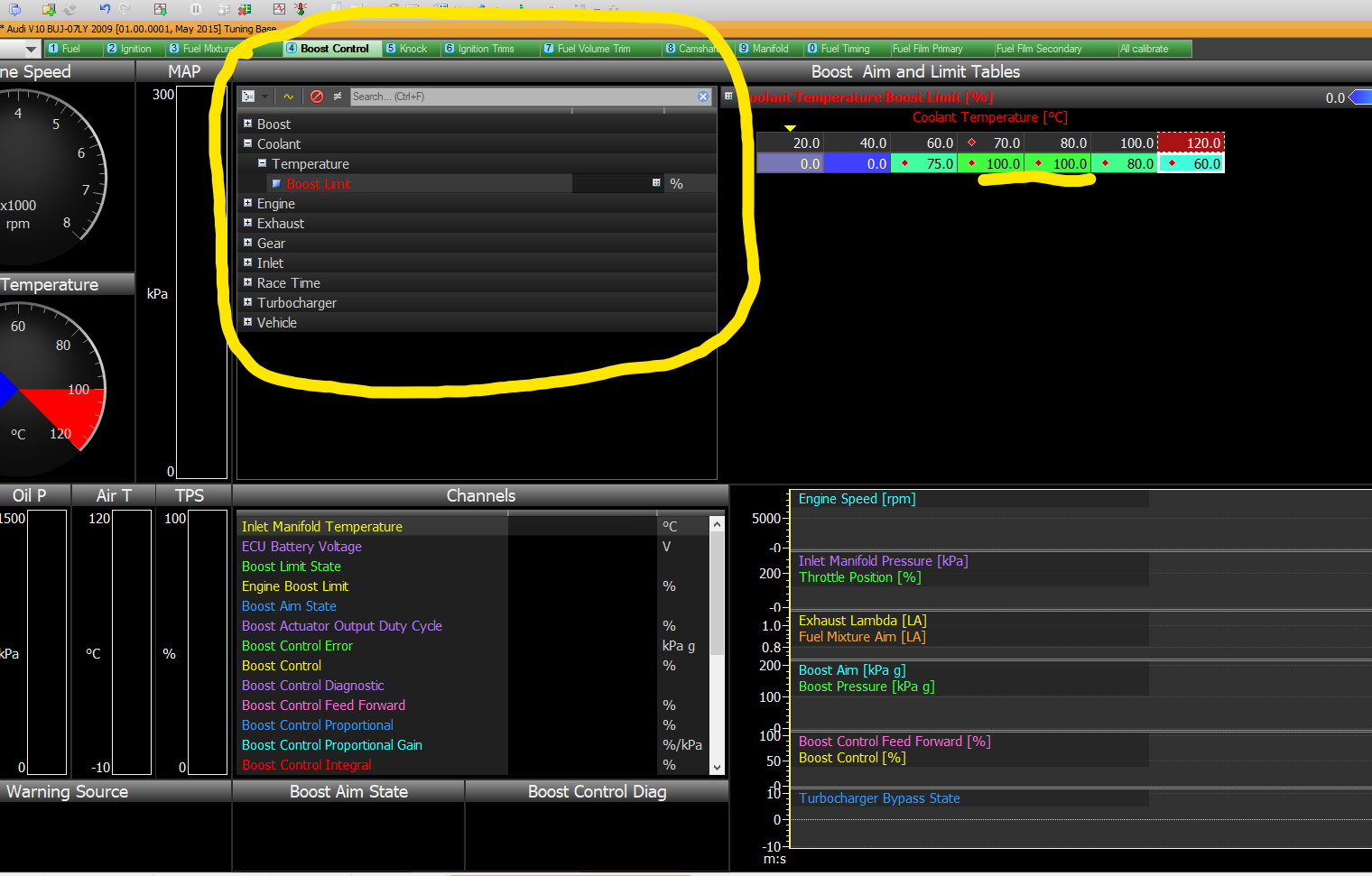

Annotation 2020-02-11 133409.png (142.36 KiB) Viewed 13096 times
Please note that if this isnt set to 100, it will cause the boost to be limited. I'd recommend going through and changing all the boost limits to 100 where they might be lower, where not desired to be in effect.
