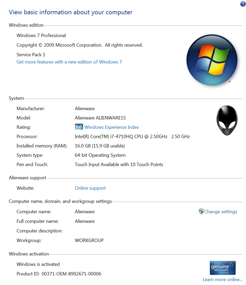

On my computer there is display bug that involves many of the display windows. I've attached a picture of the issue as well as info about my computer.
Some of the windows are black instead of white, but still nothing displays. If you right click on the blank window and click display list or display tree it fixes the issue but only until you close tune.

Ben-S wrote:On my computer there is display bug that involves many of the display windows. I've attached a picture of the issue as well as info about my computer.
Thanks Ben,
We discovered this regression shortly after the beta was uploaded. This issue:
Bug #13561 Calibrate control sometimes just shows blank help after loading package
Will be fixed in the next beta which should be uploaded today.
