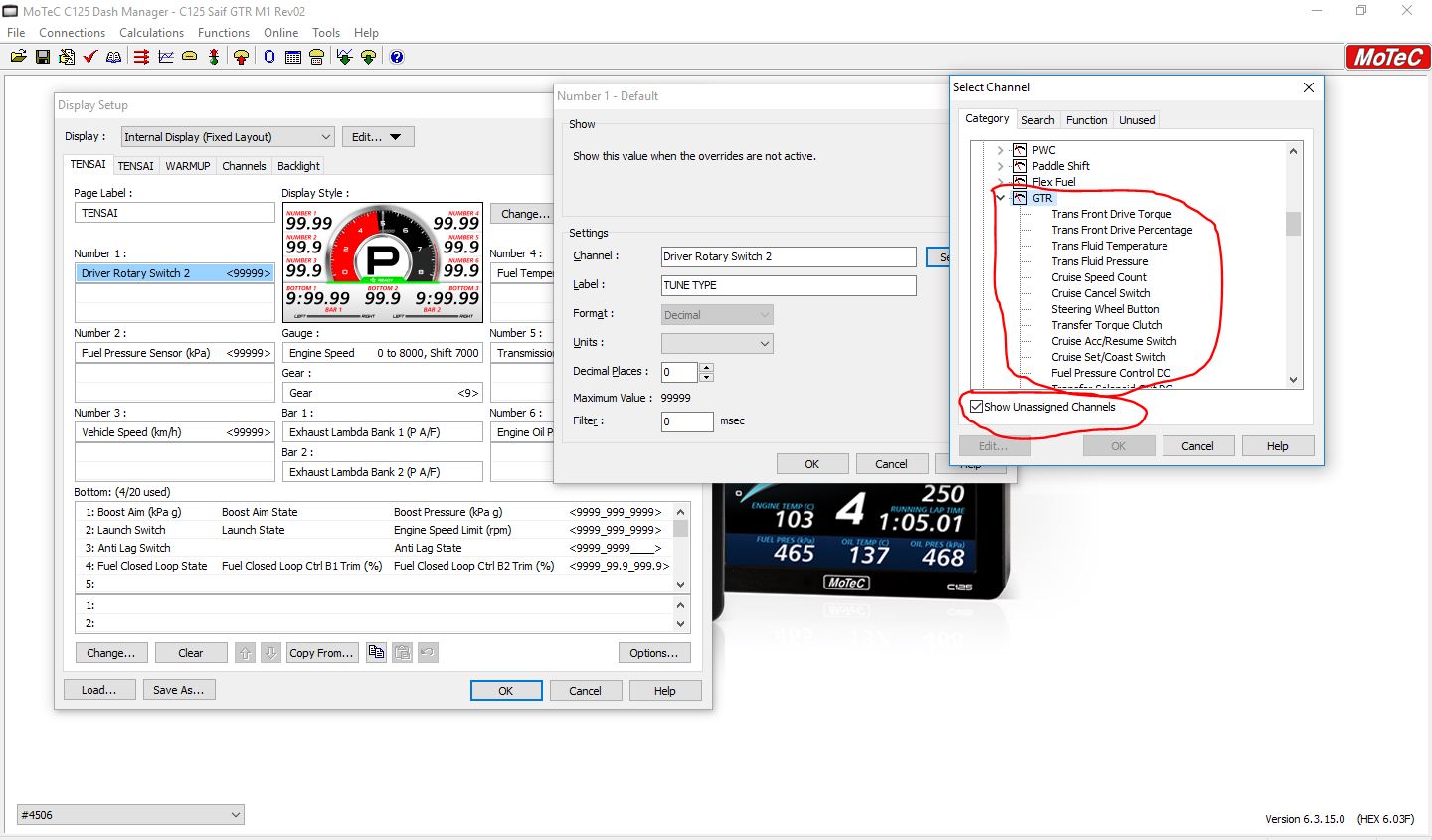

we are trying to setup a Motec C125 dash with a Motec M150 PNP.
the Motec C125 Dash Manager Channels List is showing a GTR specific channel list, but it is "Unassigned"?!
if we check the " Show Unassigned Channels" box, the channels will show and can be selected, but the channels will be not active on the dash screen; will always be Zero!
how can we use these channels on a C125.
it will be also very valuable if we want to use C1212 as a replacement of OEM Dash.
thanks
C125 GTR Channels Unassigned.JPG (183.69 KiB) Viewed 9728 times

The channels are unassigned because you need to setup a CAN template to read the channels in. If you go to Connections>Communications and then add the GTR Template (see below) the channels in the template will be assigned and you can use them elsewhere in the config.
M1_GT-R_0x660_Version 1.CC7
(8.12 KiB) Downloaded 1036 times

Dear Adrian,
thank you for the reply. GTR template was missing from my system file.
now all are working well :D
Great Support as usual.
