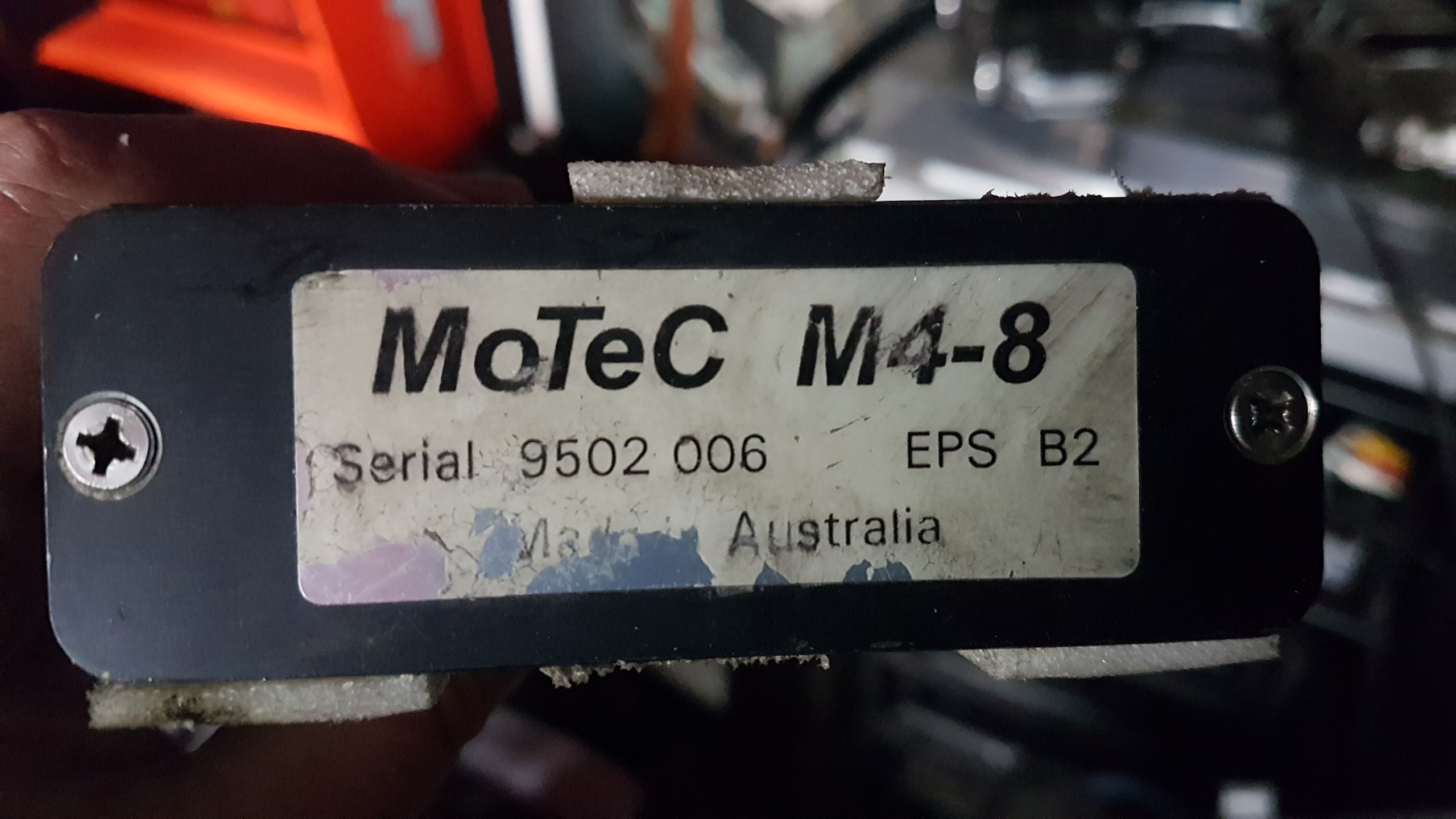

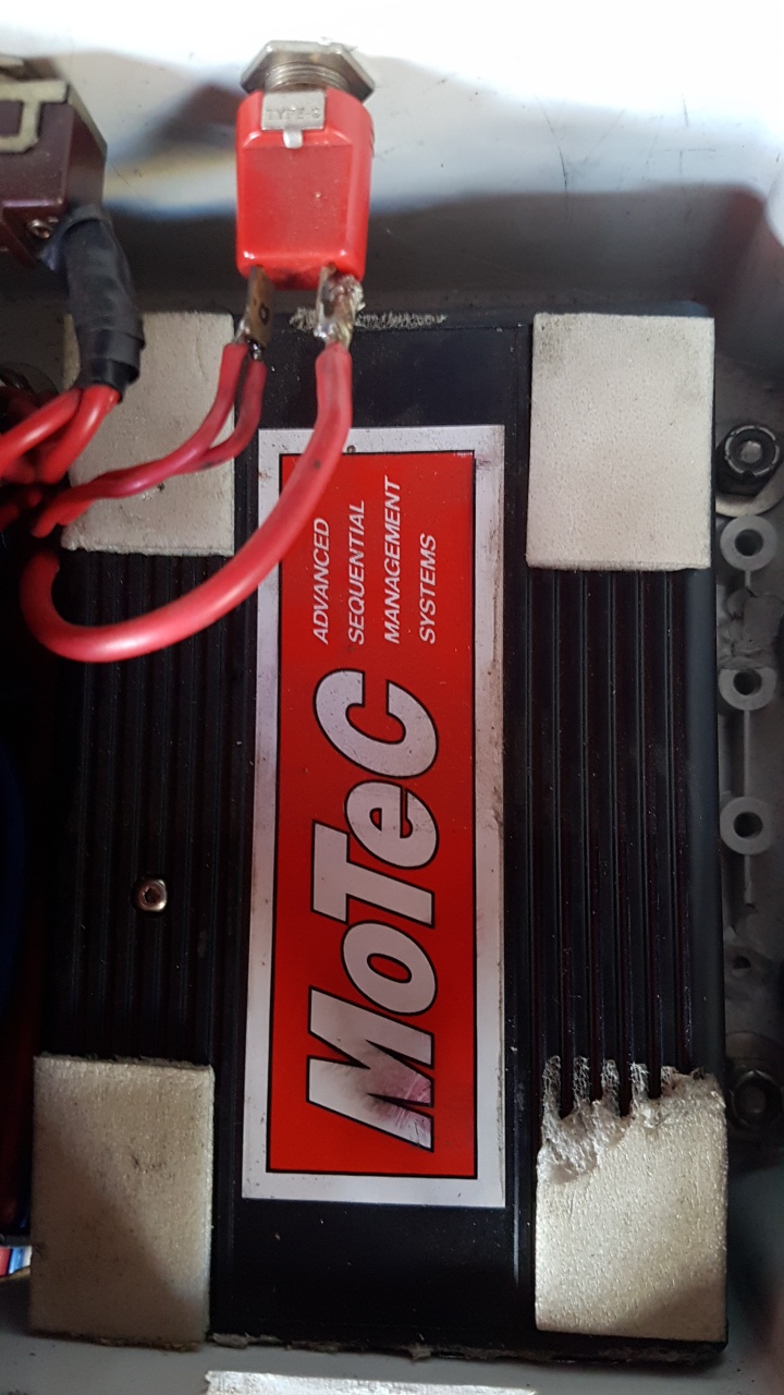

Hi, and thanks for the responses, PLEASE NOTE however my unit is a very old Motec M4-8 Serial number 9502 006 EPS B2, not an M4 nor a M48, it was built I assume 2003-2004???
I have attached a pic for reference
Very happy if current M48 software works but I doubt it
Regards Doug

Re: Motec M4-8 9502 006 EPS B2
PostPosted: Tue Apr 13, 2021 5:45 pm
by SprinterTRD
M4-8 & M48 are the same device.
You just need to download 6.2 M48 software connect to the ECU via the MoTeC PCI cable and it will tell you what version is in the ECU if there is a mismatch.
