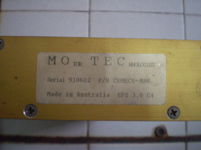

I have the pictured ECU, may I know which software supports this product? Thanks.

This ECU is called a 2 group ECU. It has two injector outputs and one ignition output. It is setup to use a magnetic sensor for its crank sensor.

Thanks Sprinter, which means I can use the 2 group software thats downloadable from this site?

You will need 2 group verson 3 software for this ECU however you will also need a transmit modem which are rare.
MoTeC has a diagram how to make a PCI cable work but this involves some electronics to make it work.
You could also use a hand calibrator to tune with.

Where can I find the pinout for this ECU? I'm well versed with electronics so if you can email the details on how to build the comms cable to PC interface I'm sure I can do it. Thanks for the help.

The pinout is available on the .AU website

You will need to get a MoTeE PCI cable, the attached document describes how to make an interface for the 2 group.
DTN0007 2Group Connection with PCI.pdf
2 Group communications
(61.29 KiB) Downloaded 1992 times

Hi Guys, has anyone made the transmit modem supliment and did it work?
I have had two goes at making one but have not been able to get any comunication. I have sent the ECU to the local Motec guy who has been most helpful and he has been able to comunicate with it using his "real" transmit modem.
I am starting to wonder if the circuit actually works so if anyone else has made one i would be keen to hear from them.
