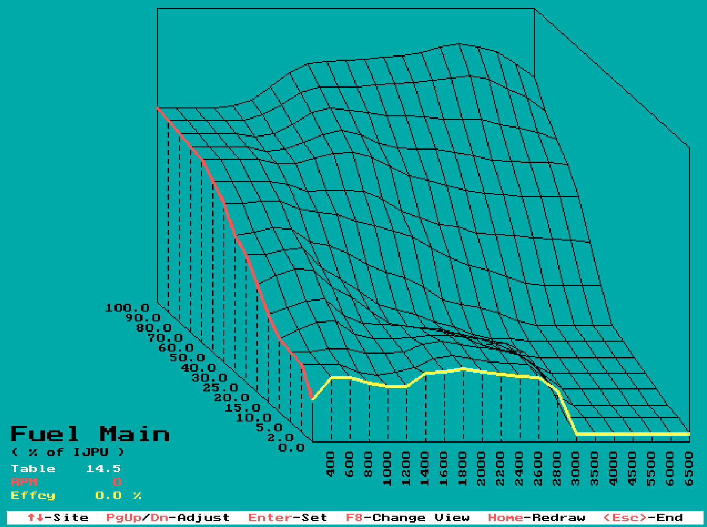

Postby Stephen Dean on Fri Sep 20, 2024 3:53 pm
Is this what it looks like?
Mx Fuel Main Graph.png (37.96 KiB) Viewed 8687 times
Are you running the EMP natively in an older version of Windows, or are you using an emulator like DOSBox? It sounds like there is an incompatibility with the graphics setup that you have an the EMP.

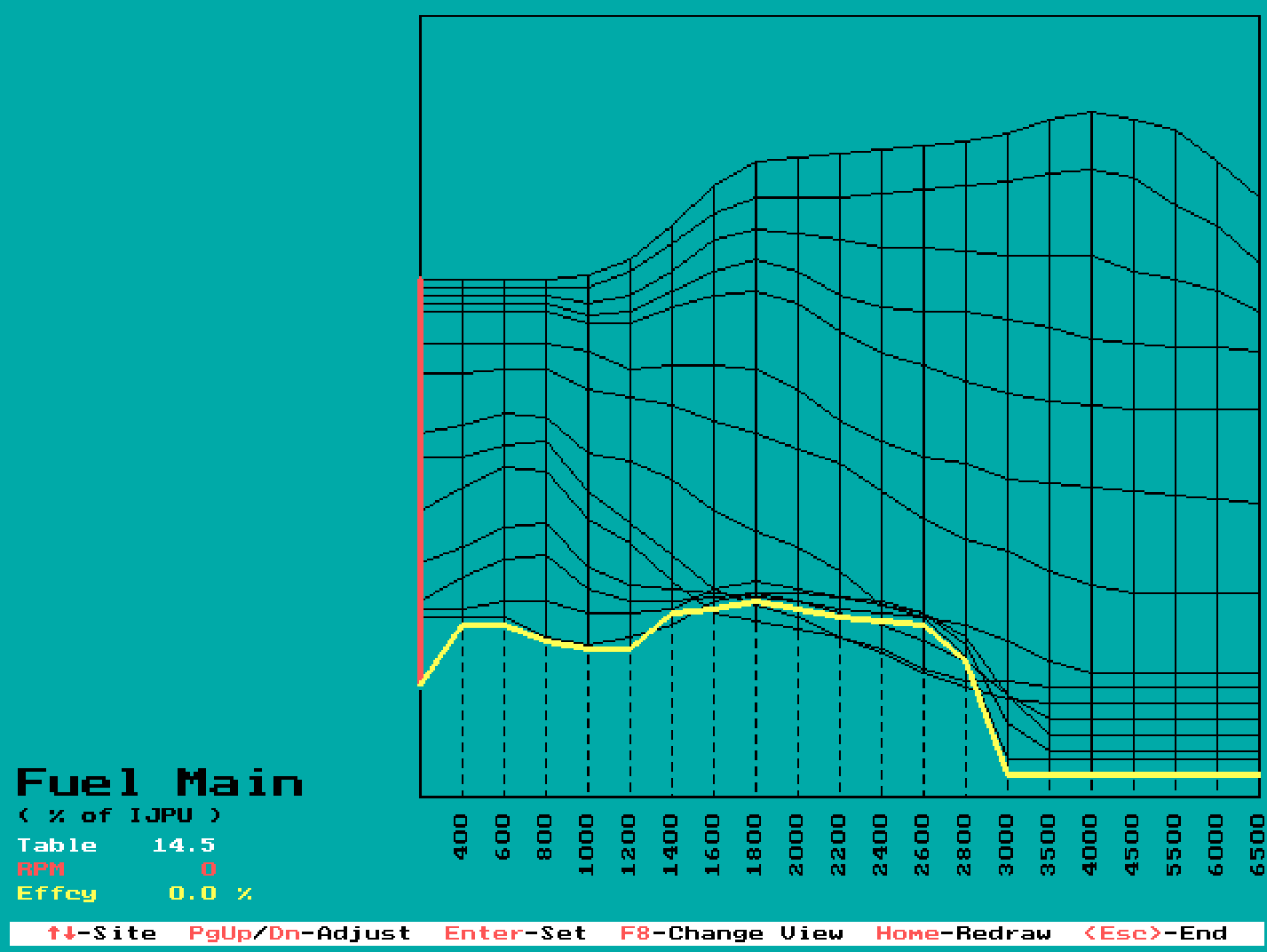

Postby Stephen Dean on Fri Sep 20, 2024 3:56 pm
If it looks more like this, then use the F8 function key to scroll through the different views available.

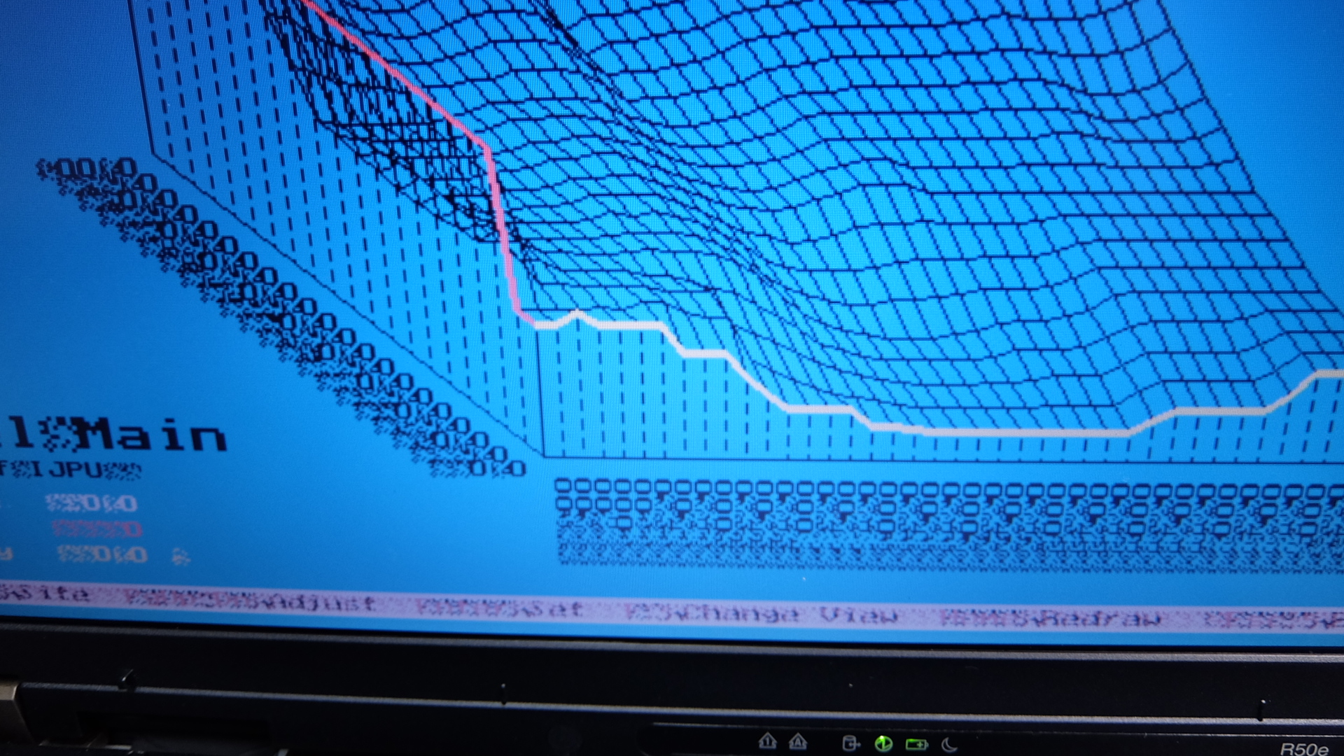

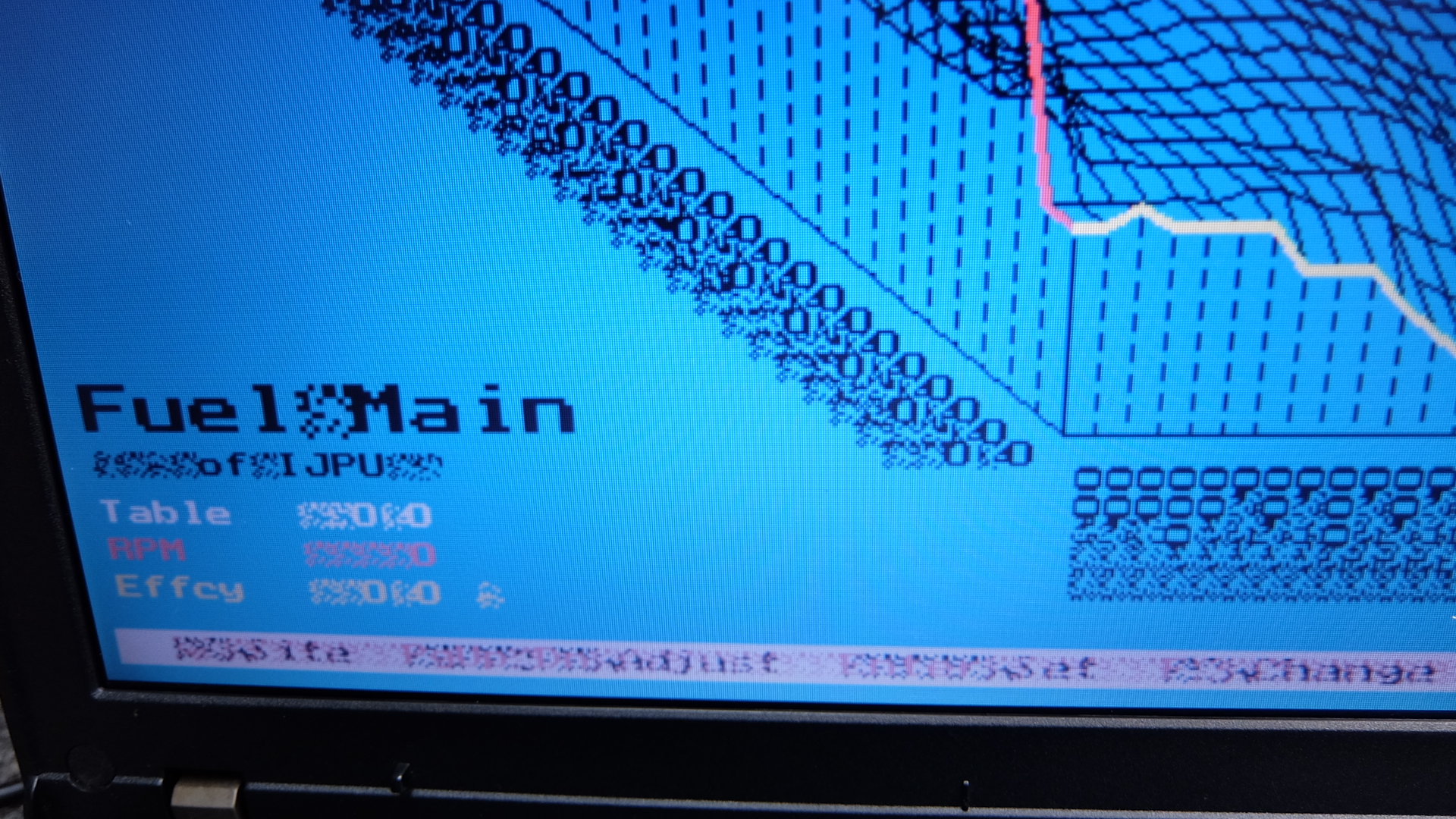

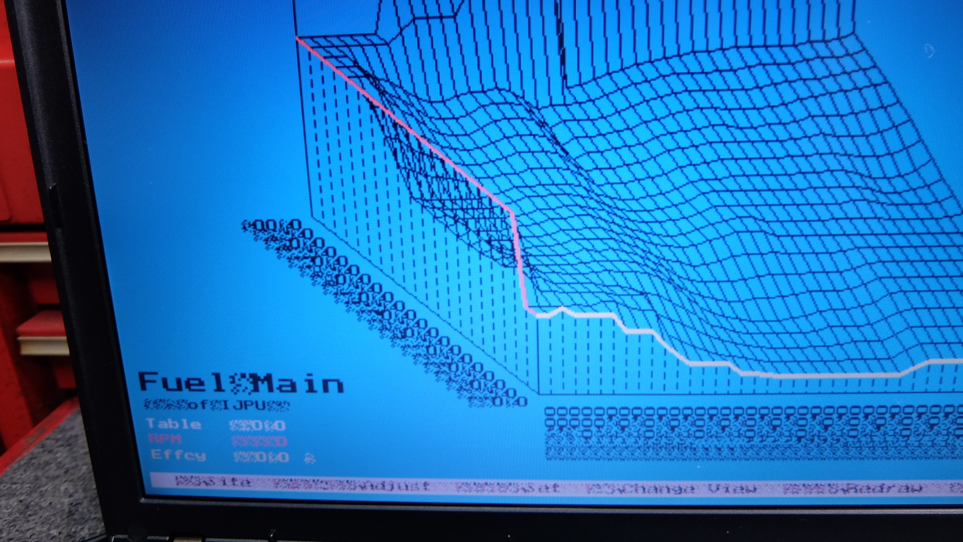

Postby kotaro-jpn on Fri Sep 20, 2024 6:57 pm
Thank you!
I figured out how to upload.
When I press the "G" button on my PC, this message appears.
Pressing "F8" doesn't change the symptom.
kotaro-jpn

Postby Stephen Dean on Mon Sep 23, 2024 11:26 am
That looks like a Video driver incompatibility that is preventing the data from being displayed correctly. Make sure that you have up to date drivers for the video card, you may need to play with some of the video settings to get this to work dcorrectly. This is not something that we can help with.
Posts: 1852
