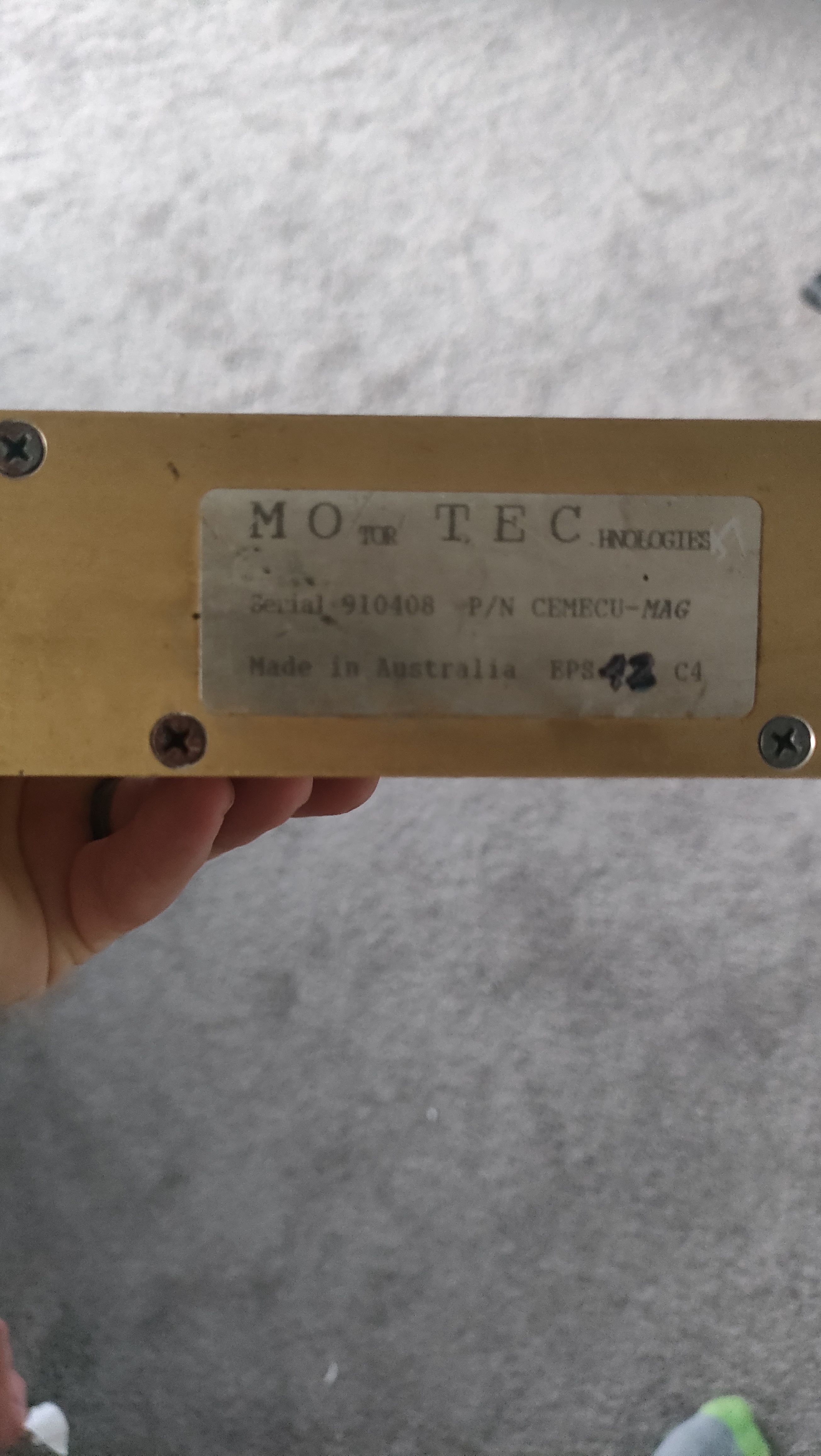

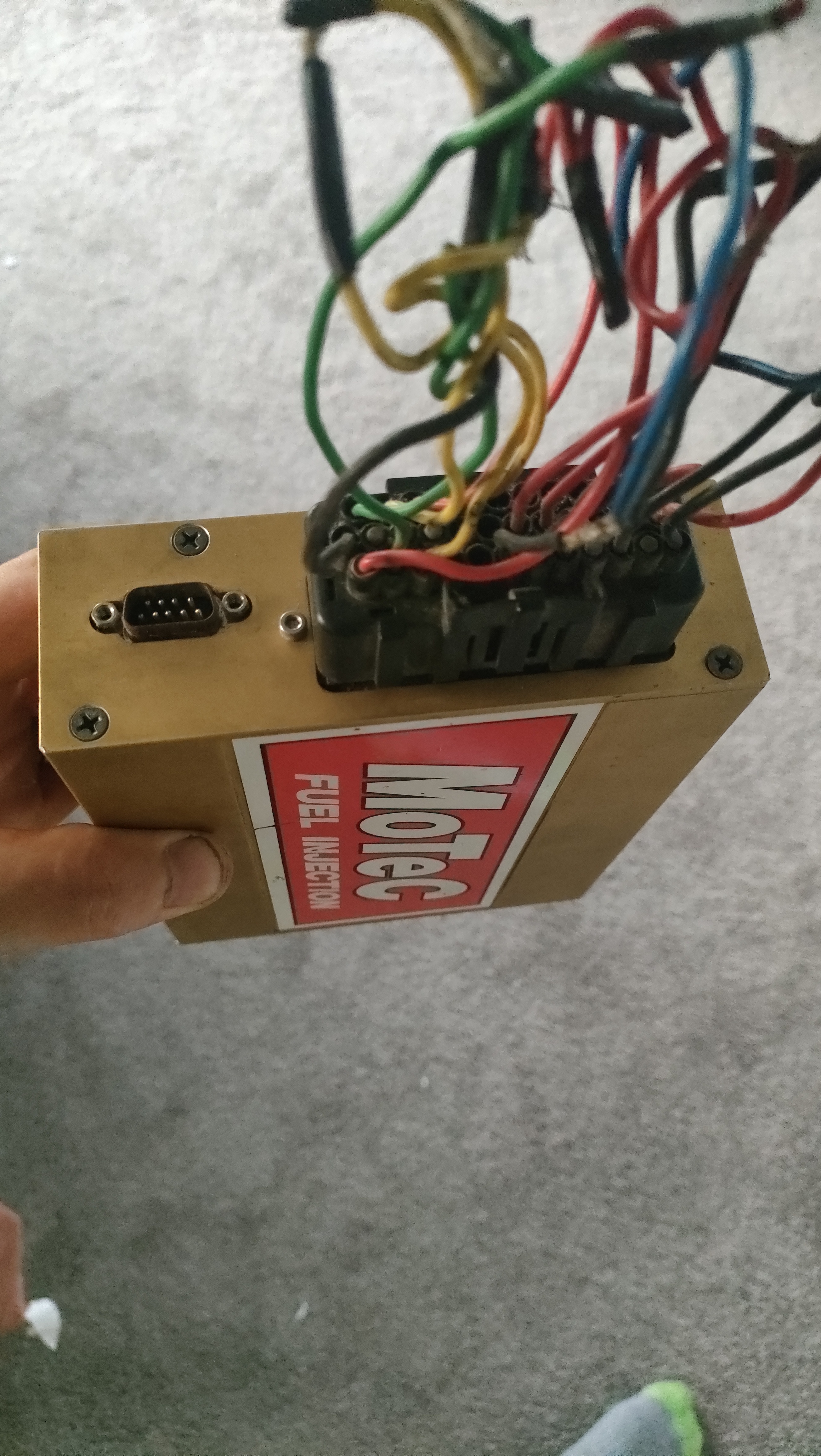

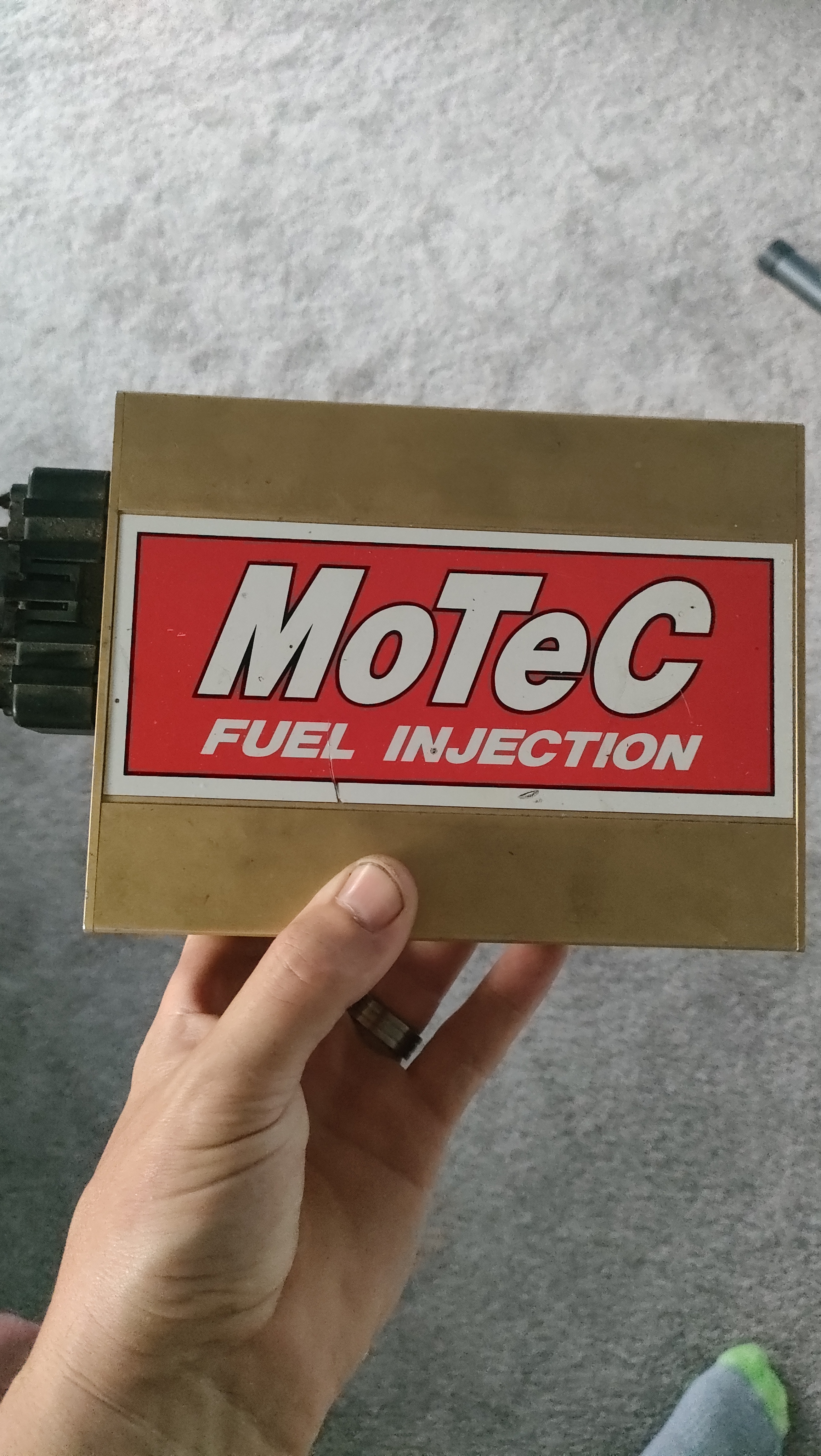

Hey everyone not sure if this is in the right place ive come across an old gold box motec. I no nothing about it or even what it was configured for etc.
I was wondering if anyone could tell me anything about it please pictures attached. I would like to use it if possible on my boosted application

This is a 2 Group ECU that was manufactured in April 1991, it has very minimal support for any current engine, there is no boost control functionality and the injectors are fired in batch fire. There is also no support available for these ECU's due to their age, and they are almost impossible to tune due to the lack of PC connectivity or the hand controller that it is designed to be used with.

Hi there doesnt appear to be an output for the fan? is the ecu clever enough to run without idle control valve?
for map and iat sensor i assume i can use something generic that matches the amount of wires on the ecu itself ?
also the injectors you mention before there in batches so will have to work out the firing sequence .
also there what appears to be aux slots for optional extras?
but before i go any further i would assume i would not need to power up ecu to the car but use the rs232 connector to a computer to see it works/ communicates ? do you have any notes for the distributor wiring and module for the wiring up set up

The model type is 2 Group. These are 4 generation old ECU's, we have had the M4, Hundred series and now M1 ECU's since these where first made, and are really suitable for old engines like the Rover 3500 V8 from early Range Rovers.
This ECU is really not suited to what you want to do, It was not designed to work with a turbo charged engine as it doesn't recognise manifold pressures above atmospheric, it only supports limited injectors and sensors and is usually used on an engine that has a distributor.
I would not recommend using this ECU, unless it was replacing an existing installation that is already using a 2 Group ECU.
