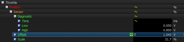

Postby Stephen Dean on Wed Jul 24, 2019 3:00 pm
Hi Eddie,
As the Motorcycle Drag Race Package is a custom Package built on an older base than our current Packages, there are some differences in the functionality compared to what I described earlier.
The Parameter that you need to find is Throttle Position Sensor Offset, with the throttle control lever in its resting position, select this Parameter and then press the Q key to set the 0% value on the throttle.
Motorcycle Drag TPS.PNG (9.91 KiB) Viewed 28056 times
