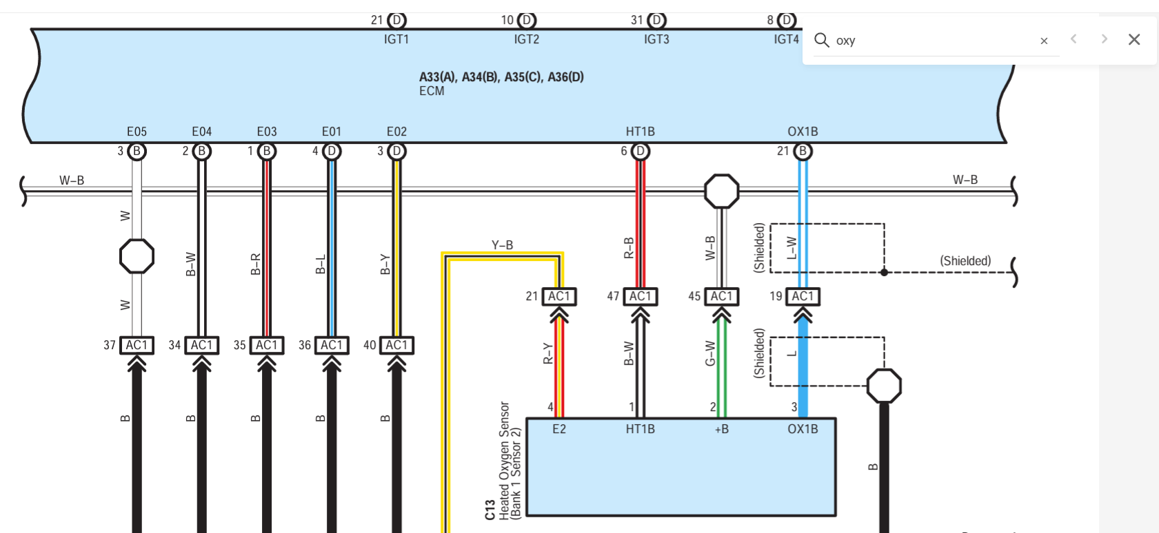

I have a ft86 customer who wants flex fuel, the visconti sensor is already in the car and plugged in and powered by sensor 2 of bank 1.
is there a clear path to using the FT86 package we have installed to read these values from this connector?
should I swap some pins at the ecu connector to get into the M150?
or
should I just wire it into the supplied spares connector?
or suggestions?
Thanks, Troy

The Toyota 86 package has flex fuel support within the Alternative Fuel subsystem.
The fuel composition sensor will need to be wired to any available UDIG input, once you have the sensor wired and configured the attached guide should explain the tuning process.
