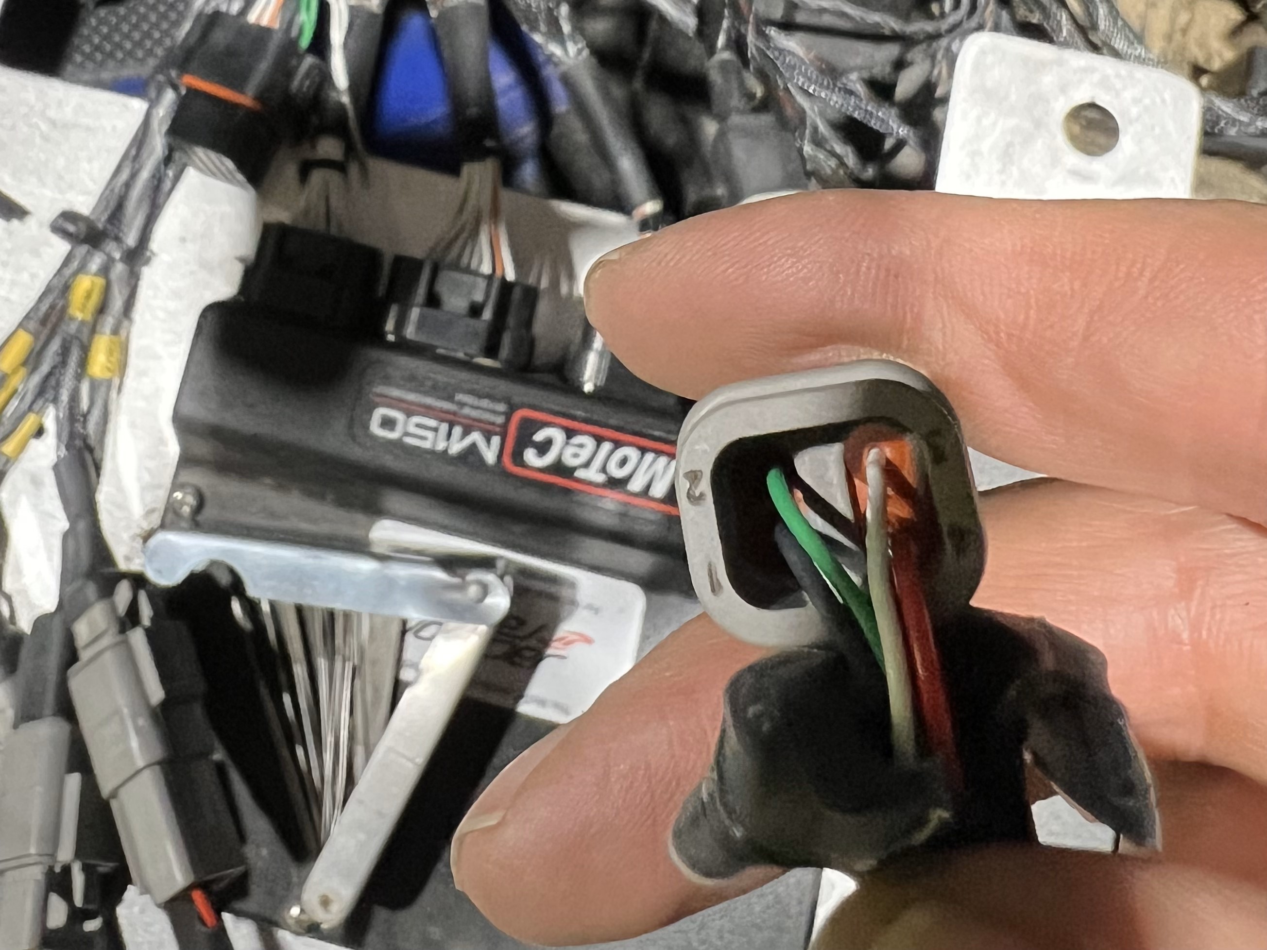

As mentioned above the only CAN wiring going to the dash is CAN 2, not CAN 1. CAN 1 would get to the dash through a 6 way connector from the CAN expansion harness, the CAN expansion harness that came with the kit didn't terminate in one of these, only the 4 pin connector, labeled DASH.
I took the time to go wire by wire testing CAN from the Dash to the ECU. I found a discrepancy in the 4 pin connector from the dash harness to the CAN expansion harness. At that connector, the white CAN 2 wire from the ECU was not pinned to the same terminal as the white CAN 2 wire going to the designated pin on the dash.
With that corrected so that CAN 2 both high and low are now getting to the designated pins from ECU to dash, I am no longer losing CAN 2 when I plug in and power up the dash.

From the main M150 loom, the 4 pin CAN 2 related connector (picture attached) has the wires for CAN in positions 2 (green) and 3 (white), and the Race Loom has them in pin positions 3 (green) and 4 (white). Originally I tried changing the wire positions at the beginning of the CAN expansion cable, but of course then the LTCD and the CAN itself went down. This made sense as the rest of the MoTeC CAN modules would be expecting the original pin assignment. Where I am confused is why does the dash want the 4 pin wire assignment different than the other modules? I was anticipating all 4 wire CAN connectors for each CAN device on a shared CANbus to have CAN High and CAN Low in the same pin location throughout.
What I could use help with is the other 2 wires (blue and pink) in the C12X 4 pin connector, what dash inputs should be on those wires? I am asking because while the CAN no longer drops when the dash is plugged in and powered up, I am still not seeing any CAN activity displayed in the dash. My hope is that it is related to those 2 wires.
