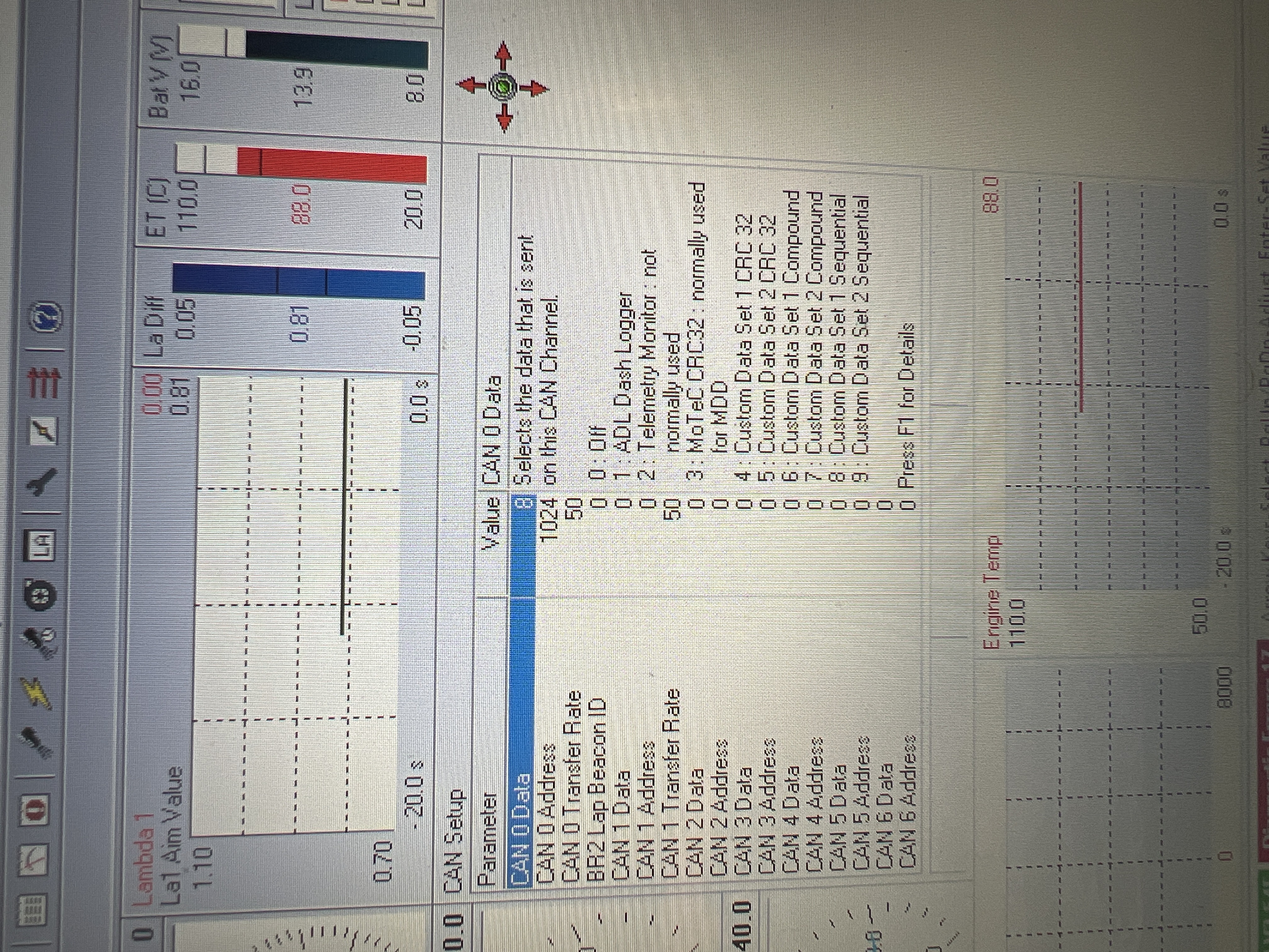

I have a Motec ECU and trying to see if I can get it to work with a Garw IC7 dash.
I can program the Motec to send customs data sets over CAN but I’m unsure of the structure, CRC, compound, sequential, etc and then how to assign these correctly in the Garw dash.

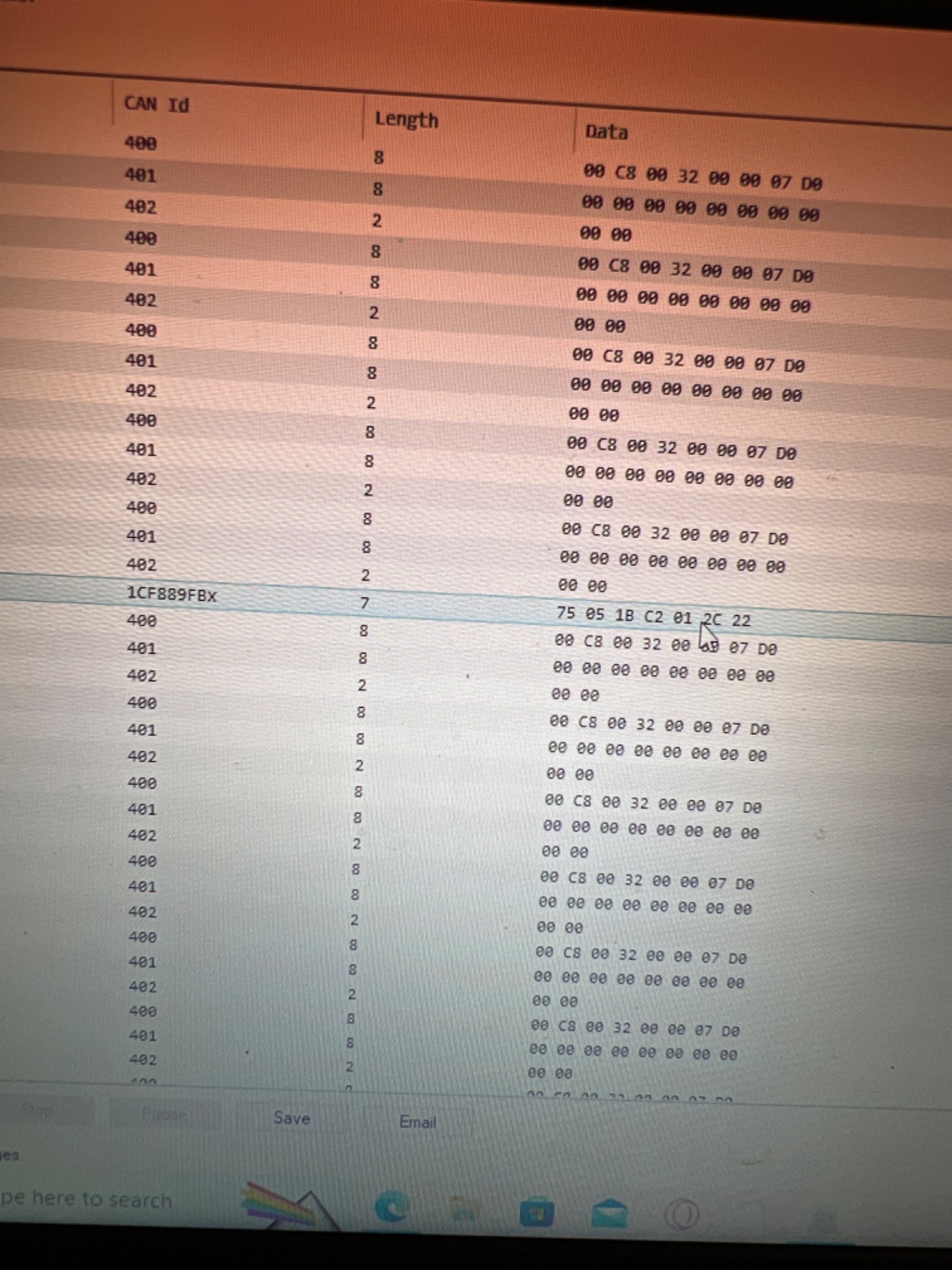

How do I find out what channels/IDs are what from the Motec, and then I can hopefully assign these in the Garw dash.
I have the Motec CAN inspector so can see the CAN data but feel it’s like needle in a haystack unless I know where to look

Ask your MoTeC dealer to share with you DTN0019, that has the info you want.
You will need to configure the channels you want to send as either compound or sequential messages. Use this info to configure your dash.

The issue with the CAN Data out of the M800 is that it isn't formatted in the normal CAN format, it actually is closer to a serial data stream.
If you look at the M800 receive template in one of our Dash Managers, and then compare it to the M1 templates, you will see a quite apparent difference in the addressing and offsets in the two templates.
A number of devices either require having the manufacturer write a specific receive template for the device, or cannot receive the data.

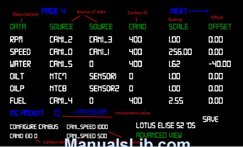

Postby The Cable Guy on Thu Jun 29, 2023 6:16 pm
I know you can change message address and "i think" what part of the message to read.
In advanced view custom configurations are possible for all data channels
Additional pages are accessible once in advanced view for the following
functions
1. Manual configuration of data channels by mapping input feeds to data
channels with custom scaling and offset
2. Mapping of inputs to tell tales and warning lamps
3. Odometer correction
4. Custom sensor calibration
