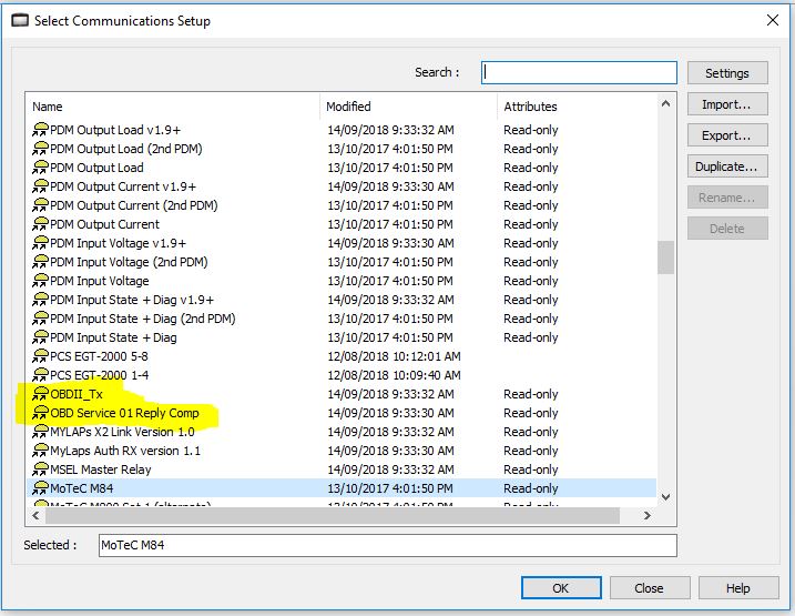

Postby rntechnologies on Thu Jan 31, 2019 2:40 pm
Within the dash manager you should be able to select the OBD communications templates.
If you add both of the below templates to your dash, it will transmit and receive the required messages.
