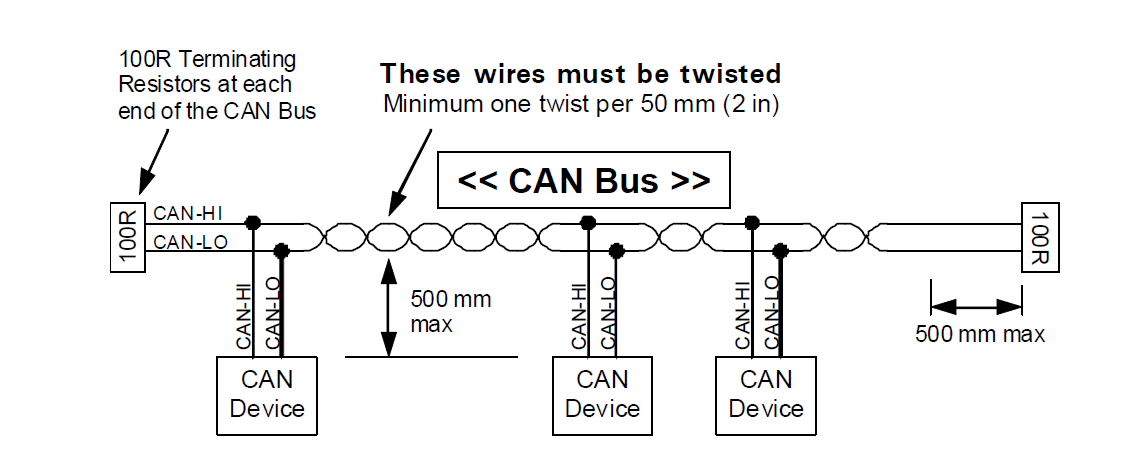

Gotcha. I now see that in this diagram in the manual screenshot attached. I guess I am just confused on how the can bus is connected to the c185 then. If I wrap two wires around each other, add terminating resistors at the end, and wire sensors up to these two wires, how does it all come back to the motec c185? What am I missing/do not understand? I appreciate the help and patience.

The little box marked "CAN Device" is the C185, GPS Module, LTC, M1 ECU or any other CAN device.
