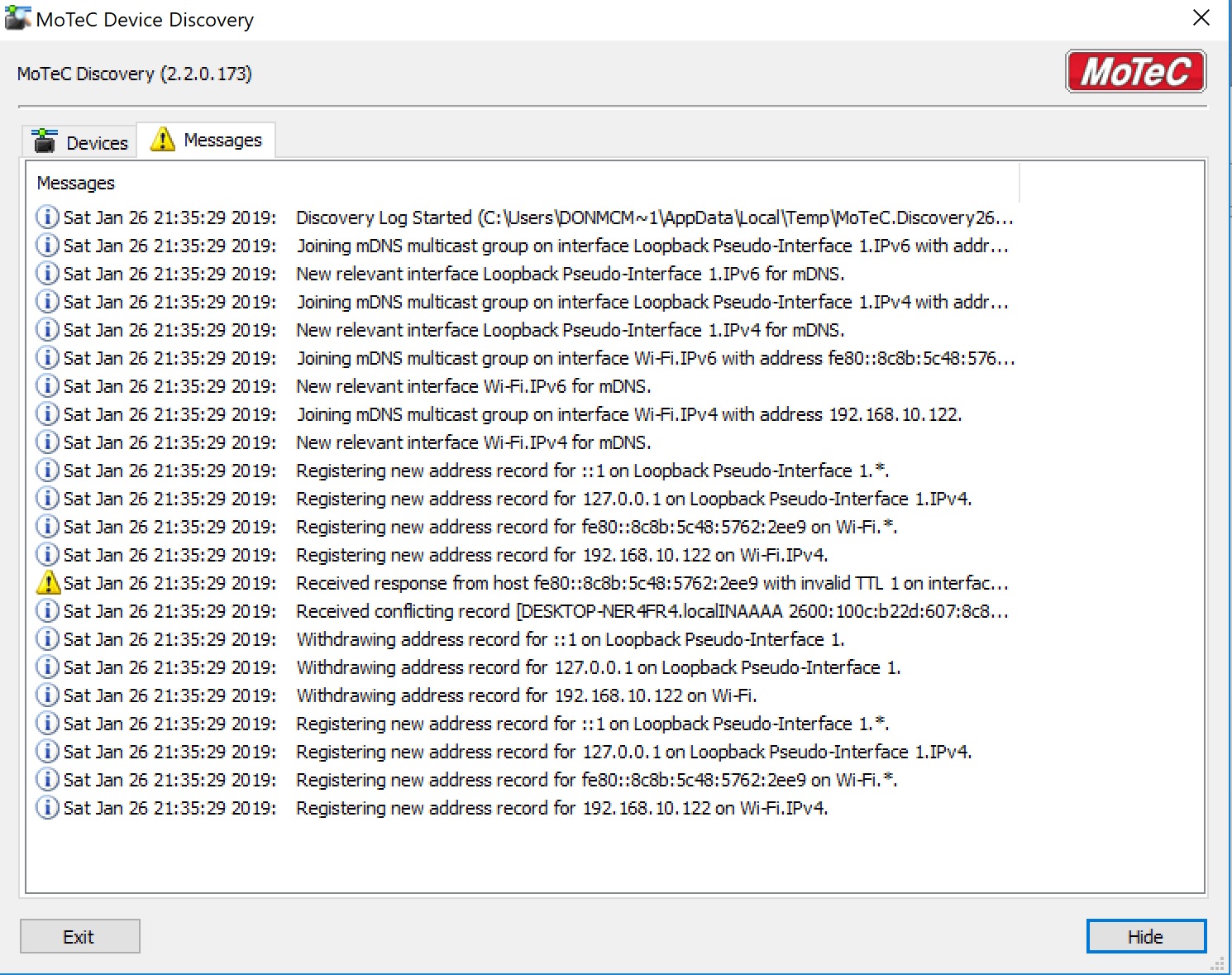

I've recently upgraded my computer and a customers to windows 10. My computer works mostly fine. His will no longer connect to any Ethernet device. I've attached a screenshot of Device Discovery in case it helps. It does not matter whether I use my WiFi device with all his hardware connected or individually connect via a cable, the result is the same.
I have a few random bugs on mine as well, for example if I connect to his C127, then his C125 steering wheel with a physical cable I have to restart my computer in between. If I use my WiFi device I do not have to restart and can switch between the two no problem. I have the same problem between 3 LMP3 cars I support. I have to restart in between connecting to each one.
Any ideas? Anyone ran into the same?

This was solved by reinstalling MoTeC Utilities. Something must have gone wrong with the initial install.
