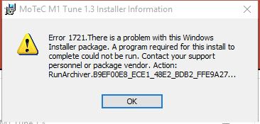

For other's to reference, this is the error message I got trying to install M1 Tune / M1 Build on Windows 10 Home x64:

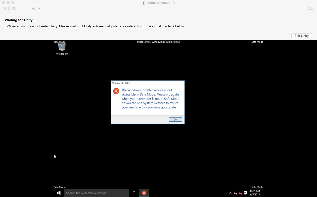

Following the above instructions, I ended up with the following error message:

I've finally been able to install both M1 Tune and M1 Build.
I downloaded the .exe files from Motec again, and ran the programs from the IE8 browser.
I suspect that the file location previously (In a sub-folder) caused issues; the fresh .exe files were saved to the "downloads" folder and run from there.
Hopefully this helps others.
