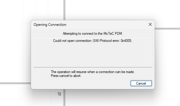

Could you help me troubleshoot my motec connection issues.

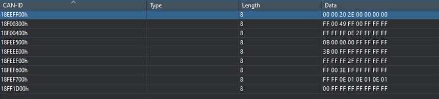

I am trying to read data (in CAN J1939) from an ECU (SCS Delta) with my PDM15.
Attached is the list of CAN messages sent by my ECU.
When I do not set any CAN input on the PDM I see that the PDM manager works fine.
When I set a CAN input in J1939, at first, I see on the PDM manager the CAN messages but after 5-10 seconds I get a 0x4005 and 0x47 error message.
In any case the CAN communication works fine, I just cannot reach the pdm manager anymore.

Does your ECU operate at the 1Mbit/s baud rate? Adding a device at a different baud rate will cause CAN communication errors.
Posts: 1441
Re: PC comms - ERROR 0x4005 and 0x47 with J1939
Postby Vertigo on Tue Dec 05, 2023 7:55 pm
Yes everything is configured at 500 kb/s. I receive the data for 5-10 secs so I guess that the rates are well configured.
