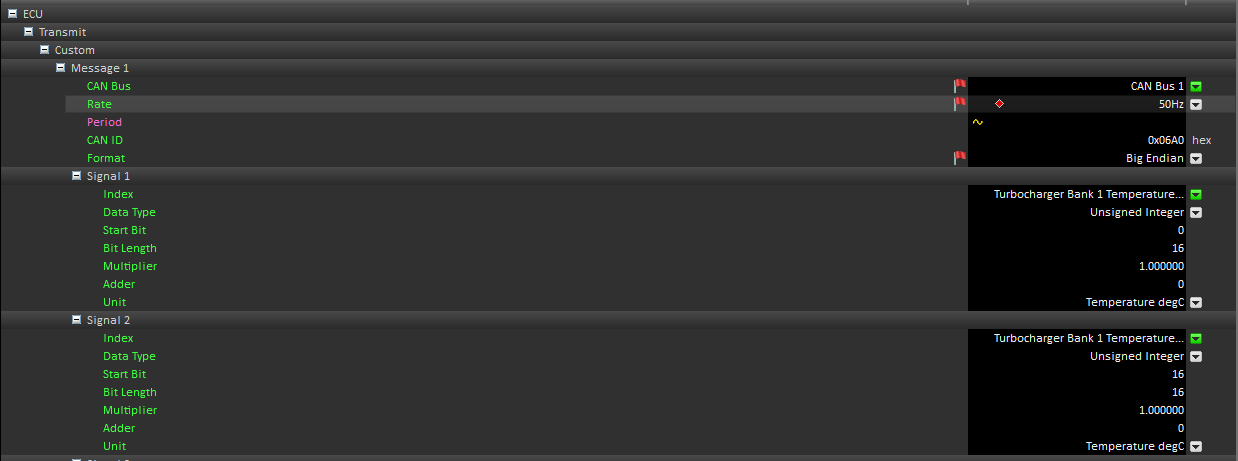

by Stephen Dean
Hi John,
To get it into the C127, you could configure a custom CAN Transmit along the line shown below.
Custom ECU Transmit.png (29.75 KiB) Viewed 3705 times

by Merlin
Thanks Stephen
I will update the CAN setup
